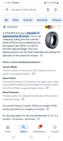

Bf Goodrich and the tire calculator online said my 275/60/15 tires are 28 inches in diameter. When i measured them by hand they look to be 26.5 or so. With my new speedometer gear meant for 28 inch tires, the speedometer reads too fast by about 2-4mph around town and even worse on the highway
So who do you believe?

With the tire mounted on the car the measurement will be less. Width of rim will also change the measurement slightly. I don't think on our 50 plus year old cars that it will ever be exact. Metric sizes won't match the old sizes exactly either. There were calibrated speedometer's on police cars then, but were they actually correct?
I did that with a speaker wire and did the math equation to convert it to diameter and got 28.01. But when I do it by measuring just the diameter with a tape measure it looks to be 26.5
That’s because of tire squat, the loaded radius is shorter…
Yeah, measure from across the tire and not from the ground up.....it'll be different.
Okay I’m gonna trust that the tire is actually 28 inches like bf Goodrich says and what my circumference measurement said. I’m gonna replace my speedometer cable because it’s way too long and from a discount part store. I also don’t think it was lubricated before it was put in by the shop and that’s why the speedometer needle is shaky at low speeds. I don’t want to keep putting speedometer gears in it because it’s expensive and time consuming. I also wonder if the original speedometer is due for a rebuild. It seems like the speeds it’s off by are inconsistent because on the highway it’s off by over 10mph and around town it’s not so bad.
