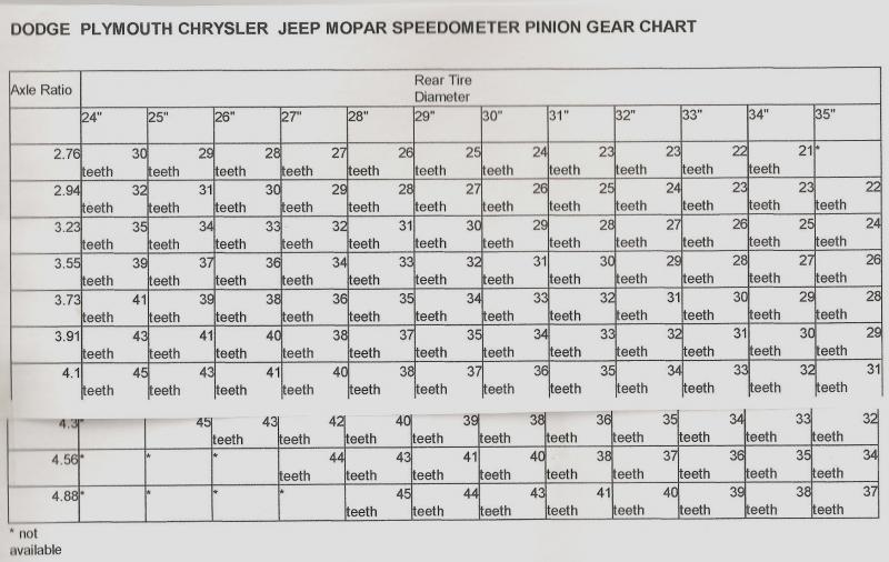

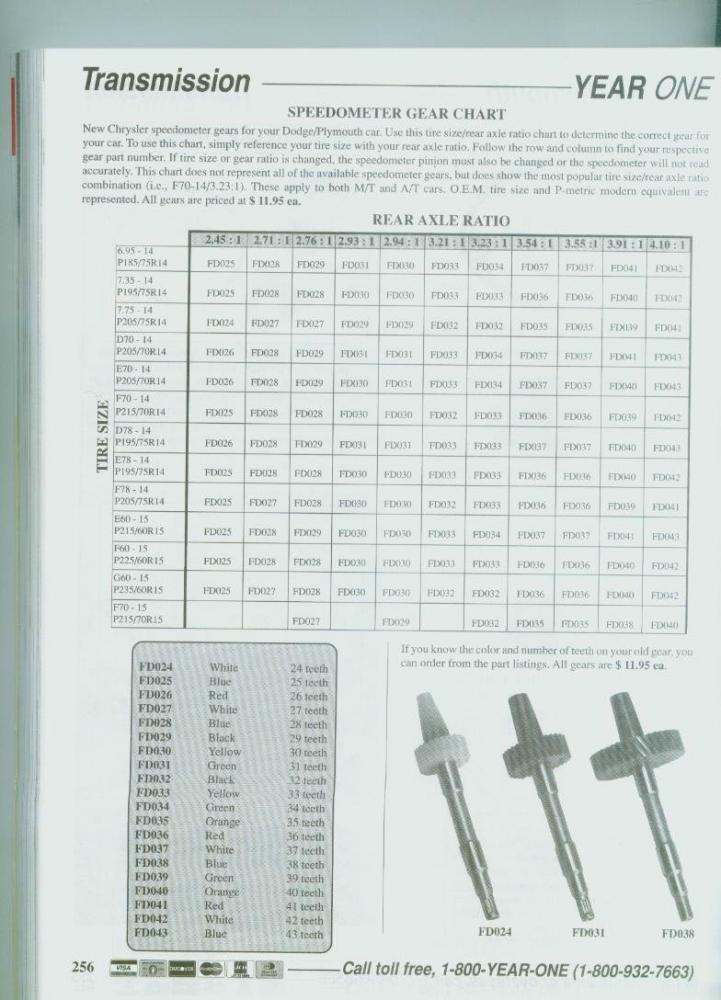

Hi guys, I'm needing help.I saw a chart on here a while ago to find speedometer gears. I changed to 373.1 gears with 26" diameter tires. I think I need a blue 38 tooth gear but not sure.The charts I've been finding don't show a 373.1 ratio. Also a good source to buy one. Thanks a lot.
Yup looks like 38 tooth. Here are two charts
Thank you very much Kernel Sanders. My memory was better than I thought.
Thanks that MoPar chart is great
