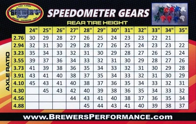

My dad just changed gears in his 67' Belvedere. Car has now has 3.91 gears with a 28" diameter rear tire. Speedometer chart shows he needs a 37 tooth gear. Is that correct for you guys with the same combination before he goes and buys a 37 tooth gear?
