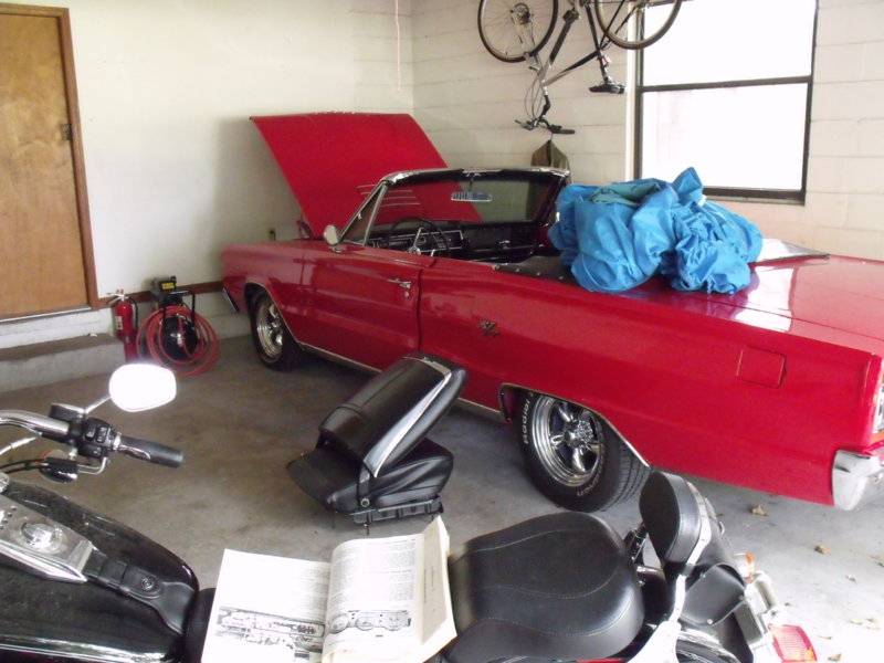

Gent's. I am working on a 66 Coronet Conv. As the enclosed picture it is clear that some "splash thing" is missing. I haven't been able to identify these parts i.e. by Classic Industries. Can anyone clarify what is missing? Greetings from a quiet Copenhagen!
Thanks for your quick reply. I have studied these parts but it appears to me they are too small to cover the gab from the back of the headlight box and i.e. the upper part of the fender. Classic industries has a set and these two parts, but I am uncertain if those are the missing parts.

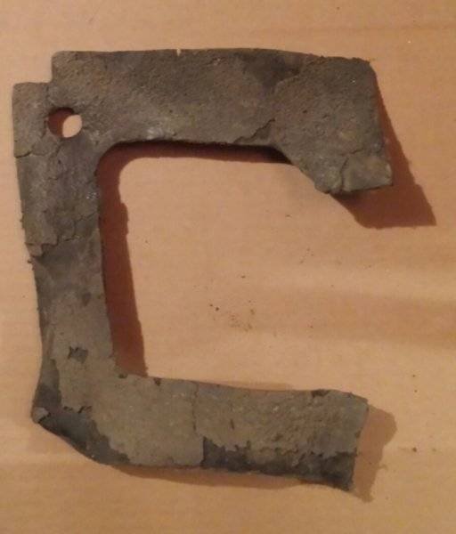

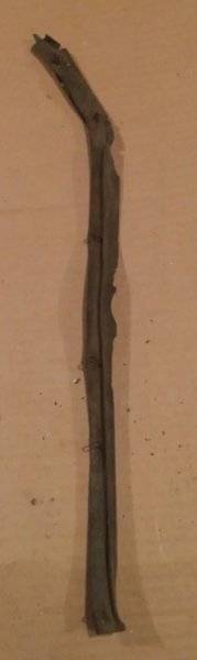

I have these 2 originals with clips if someone needs them

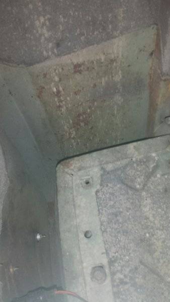

Hi joerachet, I have these parts, but do not know how to fix them i.e. if I am missing a plate to mount them on?
Hey Bodk, I will take a picture of they area they mount to and post it when I get a chance.
BTW, I visited Copenhagen in 94, lovely city, great people.
In the attached photo, The two pieces on the right are the metal fender splash shields that go up in the headlight area. The two pieces on the left are the metal fender splash shields that go in the fenders behind the front tires. You can see the rubber seals still attached to them for installation reference. The metal shields are not reproduced. See post #7 for the rubber seals for the headlight splash shields.
