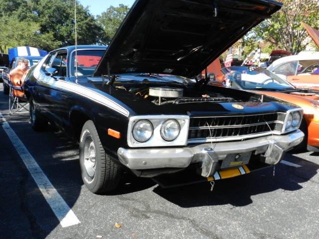

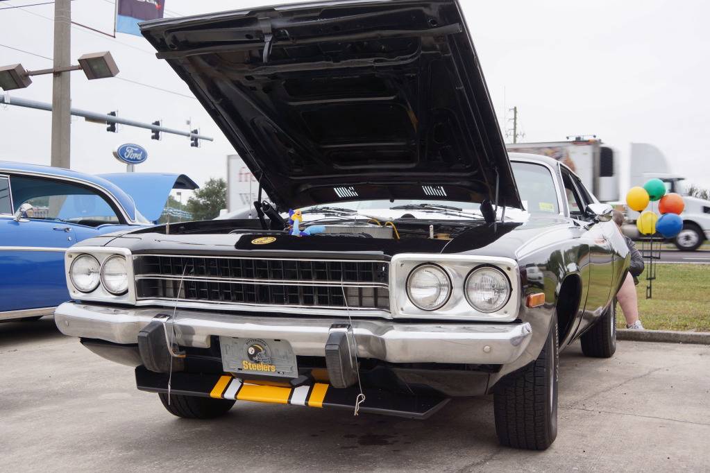

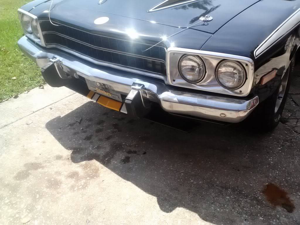

When I put one on my 74 Road Runner, I found I could mount it to the lower-front valance, right behind the center "hump" section where the front tag attaches, without any problems. If I tried to move it forward of that, the hump bulged up too much for the spoiler to sit flush.
The reason I put the spoiler on was I've always felt the 73/74 Road Runners needed a bit more prominent chin, and when I taped up the spoiler where it would fit flush and looked at it, I felt like it didn't project out far enough. So I started cutting out the center area a little bit at a time to accommodate the hump when moving the spoiler forward. I just measured the width of the hump and estimated a height and kept cutting with a dremel tool until I got it right.
