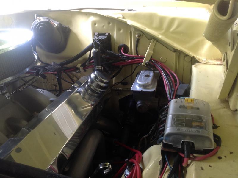

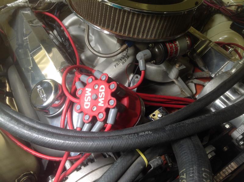

Thanks. Pics attached. I will look there too.
what ignition system are you running? are you still using the ballast resistor? Need more info
Oooh...yeah that is a different setup than the OEM stuff so my pointers will probably be worthless. Sorry man. Good luck with the fix though...

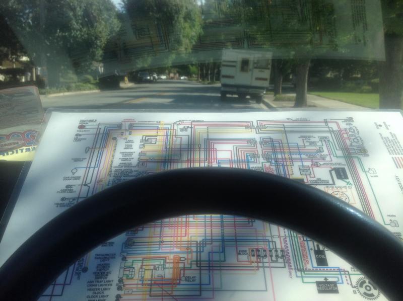

Download the schematic for your car from mymopar.com...trace the large lead going through the firewall from the large terminal on the starter relay; that wire contains the fusible link. Work from there in through the firewall, to the ammeter, and then to the in-harness splice. Look for chafed and/or metled wires when examining the harness.
nm9stheham and bigmanjbmopar I appreciate your time. Can't be sure about the lights, happened during light time hours. Did replace the electric fuel pump about 500 miles ago. jbc426 on Moparts is going to help me this weekend with this. I will follow the advice here. I will download the schematics and follow the 4 steps. Will,report back.

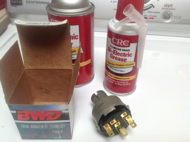

Replaced the ignition a switch. Got a few miles and it shut off. When power is lost, the lights do go out. It stayed down long enough this time to tell. Now I have power and the starter won't spin like it is the switch - except it is new. Now there is power in the car between the normal detents on the ignition. Won't start. Can walk home from here, debating...image.jpg
