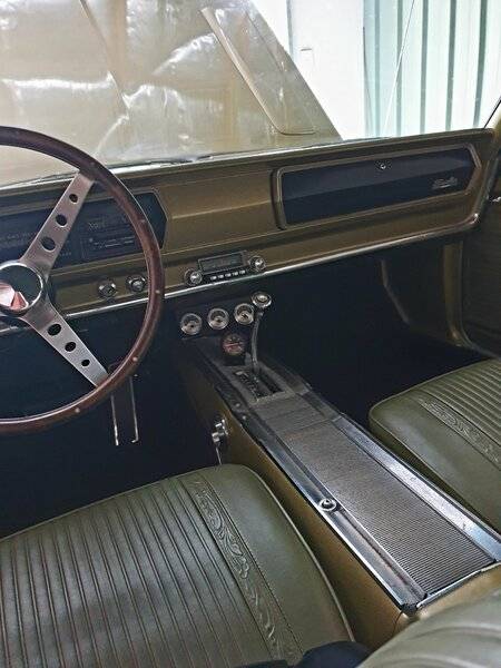

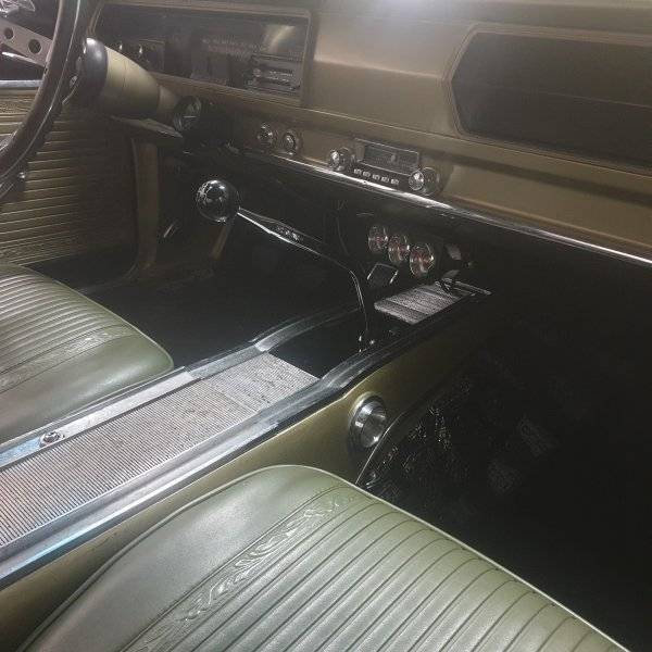

After years of internal debate I finally went ahead and got a TKX 5 speed.
Still breaking it in, still have to sort out the carpet and a few things, done about 200 miles so far, big difference.

Very nice job....I assume you have a boot arranged to finish off the console hole. :thumbsup:

This was a bit different though, I was dreading doing the work on my back with the car on jackstands, so I gave it to an experienced transmission shop who is the main Tremec agent in Australia. They're only about 110 miles from my home which was also convenient. I still "prepped" the car myself, removing passenger seat, console, carpet etc so I felt I'd had some small input. I still had reservations about leaving my car and all the possible disasters, but they did an great job and it drives really well. I went with the 2.87-.081 which suits the 3.23 rear perfectly and drops the rpm by about 500 compared to the 727 at a 70 mph cruise.

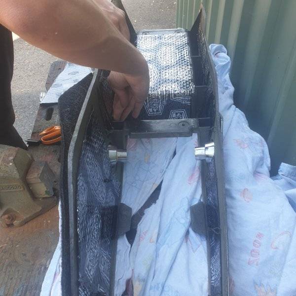

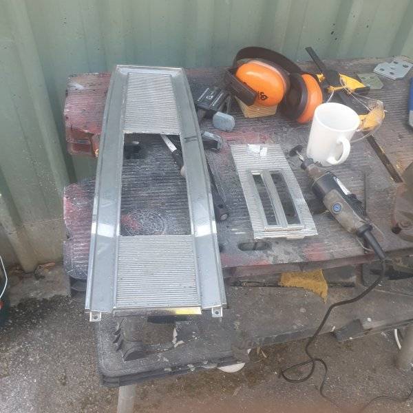

So yesterday was spent soundproofing and re-installing the console, cutting the console lid (I need a different lid as the opening is a bit big but this is fine for now). There is a boot on the shifter but it's hidden inside the console - I may get a second larger to one to go over the top.
It's a real beast to drive now compared to the auto, adds a new dimension to the experience for sure.
