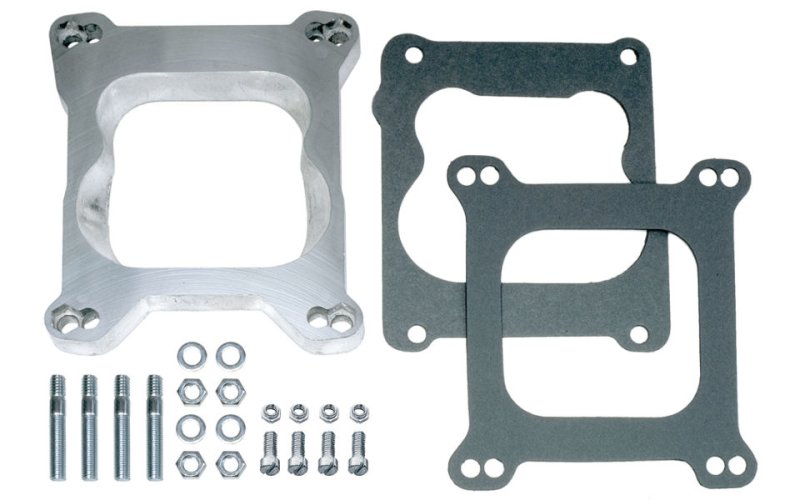

who makes an adapter to put a TQ on a square bore intake? I have a TQ that I want to use on my DP4b. Thanks
Trans adapt if I recall
I looked again, yes they have them, just to verify is this the tq to square manifold side?
Unflippable?
on second look yes they are, thanks
Adaptors are notorious for changing/losing air flow.
With some intakes, it is possible to open up the carb mounting flange to fit a spread bore carb direct without an adapter.
didnt know that, how do they cause flow loss?
I love the TQ's and run one on the 440 in my 68 T/C wagon, I went with an OEM cast iron spread bore intake since doing some research I found that the stock intakes in the smog era motors were actually great intakes with very good flow.
they are really good for stock units, I have a DP4B that i want to use
