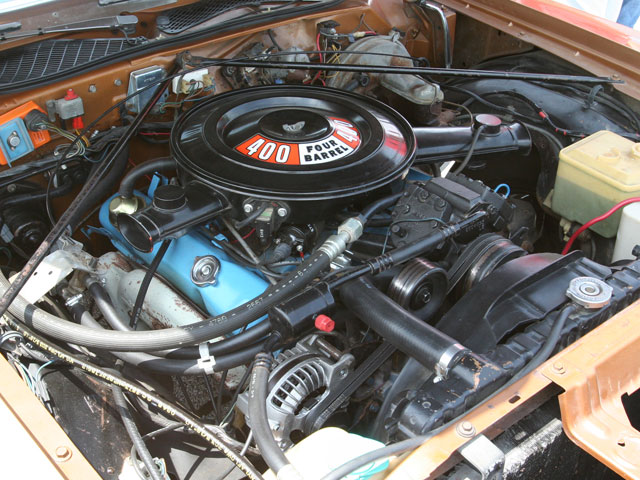

Bill, I used 906 heads, intake and exhaust manifolds, cam, and carb from a '69 383. It woke up my 400, and still looks close to stock to the untrained eye. 2003_07270008.jpg
