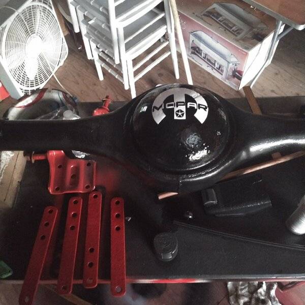

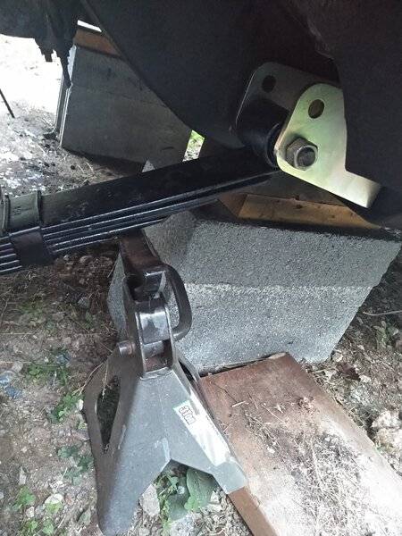

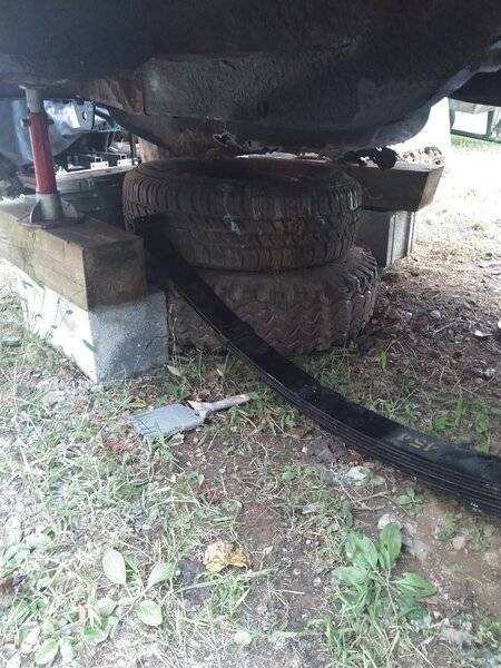

My 3800lb super stock springs (old direct connection set) look like they are just too short. I have the correct front hangers from Mancini. Haven't installed my shackles yet (really long ones from the 70s that were on my charger when I got it) but I am at a loss.
Help? Do I need to compress them somehow?

Those long shackles were normally used because of sagging rear springs, do yourself and your car a favor and get a stock set of rear shackels.
agree..through those long shackles out get the right ones (stock)
Measure your old front springs from front spring eye, to the reared center pin. Then do the same to your super stock springs (they will be 20"). The difference will be how much farther back your front hangers have to be than your originals. If they are, you should be okay.
In my humble opinion, nothing wrong with aftermarket shackles, just don't use em to Jack up the rearend. Use the shortest hole, and chop off the excess material.
33 IMP pointed out the 20"SS front segment. Stock Dodge front spring hangers are 1" longer than Plymouth spring hangers. The SS front hanger hole should be 2" longer than your stock hangers. Not sure I'm right but check it out.
To answer everyone's questions,
Yes they are the 2 inch extended Dodge hangers from Mancini: https://www.manciniracing.com/marasphaset7.html
I am NOT using the bottom hole on the shackles

It depends on which SS spring you use. There are 2 rear segment lengths. The 3800# should be the 36" rear.
The stock shackle length will work. I have also made my own with stock length and two more holes 1" longer & 2" longer. Stock or 1" long worked just great.
Update: I installed them. They were the right length, It had just been so long since I had removed the old ones that I thought the tow hitch mounts were shackle mounts :screwy:
