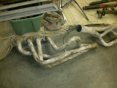

I got these in a buy it all to get the good stuff sort of a deal. Anybody have a use for them? Are they indeed what I was told they are, stage 5 Hemi headers? I was told the dual stud patten is a dead giveaway, but it's not my realm of expertize so you tell me. The collectors are cut off but would be great for the drags I'd guess. Make me an offer.

I have no idea what stage 5 headers are? Brand name?

Sounds reasonable to me, was looking for opinions as to what they are so thanks. I'll take them up to Mopars in the park this summer and let people have a look.
Your picture is for crap. It doesn't even show the flange bolt hole pattern or even both headers, yet you want to know info about them. I wouldda splattered pics of all kinds on here if I was askin for help. I swear, I think some folks just like makin stuff hard. Here's some stage V headers. Are their flanges similar?

i use tti on my & from what i can tell by the picture they seem to have a standard cast pattern not the dual l&r pattern that you see on a lot of new style heads

I purchased the first set of Stage V conversion heads in NC nearly 20 years ago using their raised port heads (they're .100 higher than stock), and I also bought an early set of prototype headers that Eric Hanson had on hand at the time. It was a blown, stroker based on the 440 block. Any of you that have a question about building a "conversion" engine, feel free to ask me, as I've been through the process and know what's required.
To answer the above questions: Stage V is the "brand name", and the company, owned by Eric Hanson, is one of the most renowned engineers in Top Fuel racing on earth. Stage V Hemi Heads ruled Top Fuel for years, and their "wax mold investment casting" process, which is same as Ruger uses to cast their gun frames, produces parts that are truly works of art. Judging by the material that's under the pipes, using the pic you originally posted, it appears they may be for the raised port heads. However, IF you are running a SS k-member (cutout for the oil pan) and the engine is being mounted with a plate or "ears", the engine can be adjusted down .100 were you to use the raised port Stage V Heads with standard port headers. They will fit.
However, if you are going for 100% stock location of the engine with raised ports, then the raised port headers will go in easier. Remember, the difference is .100
