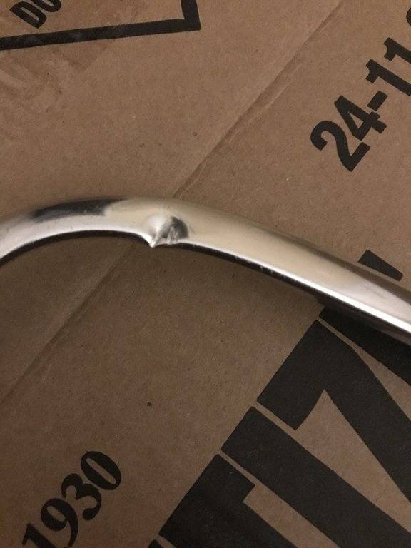

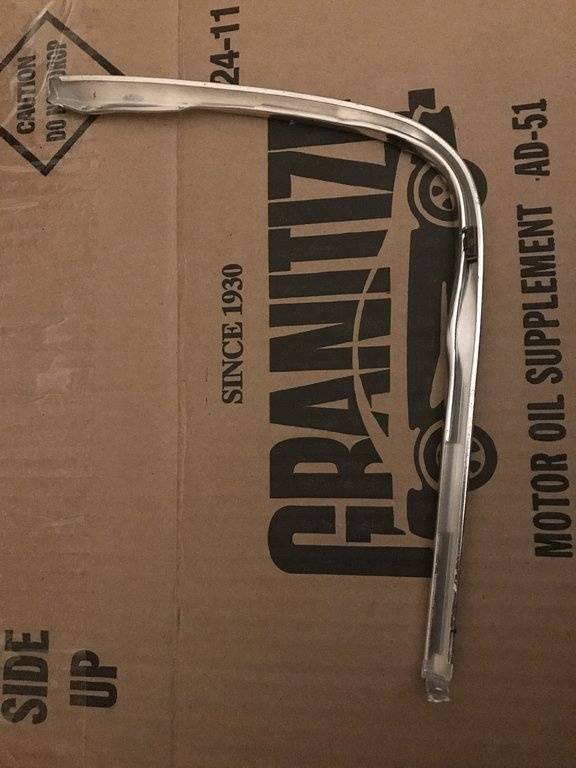

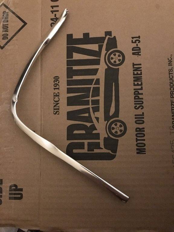

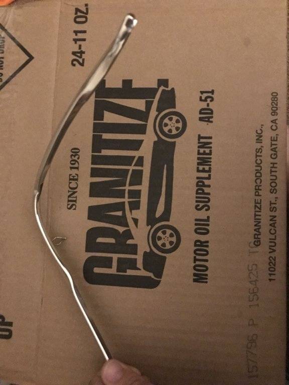

my car got backed up into when I was at work and a piece of my stainless molding got messed up. Does anyone know where I can get it repaired or purchase the side I need without having to purchase the other side too? Here is the damage.

IMO, you'll never get that back to perfect. There will always be a pinch or defect if you will in it. Classic industries sells that I think?
I might be able to fix it. Stainless is very malleable and when "worked" that piece of trim can look as though nothing ever happened.

Most times, careful picking and hammering, filing sanding and polishing will get things back to like new. I once put a hole in a piece of stainless trim on an Oldsmobile, after tapping it down and filling the area with stainless solder, sanding it flat and polishing, the repair looked invisible.
