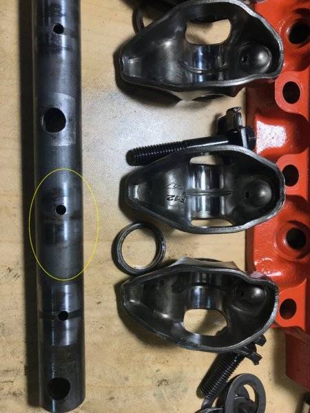

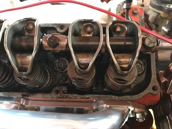

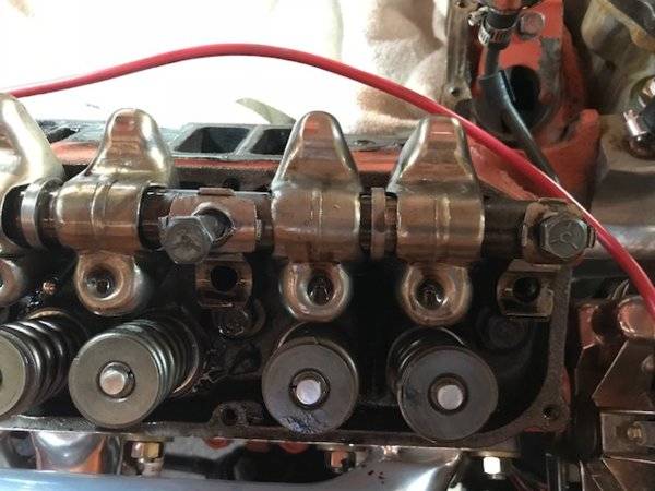

From the looks of it, especially the center rocker in top photo, I'd say your looking at some worn out parts. Rockers, spacers, the whole thing works as a usable 'set'.
Might get away with replacing some worn parts...or, just get new assemblies. Go through each part, to see what you have. Up and down play on the rockers no prob, side to side (and locating), yes, problem.
I would like to have them more centered than what I'm seeing. They don't look factory do they.
With aftermarket, you might try exchanging the ones that aren't centered to another location on the head. I used a set of Crane adjustable rockers and they weren't all made the same. Took some swapping around before I was satisfied with their centering. Remembering you have right and left rockers and keeping the right ones on those valves only.
As far as your up and down play, bring #1 up to top dead center and see how much play you have , pushrod to rocker, on those valves. Useing hydraulic lifters you want some preload, meaning pushing the cup in the lifter down. .020 min to around .060. If you have play in the pushrod to lifter then you want to invest in a adjustable pushrod to check what lenth rod you need and order a correct lenth set. If that's the case, you want to check several over the whole setup to get an average lenth, having the valve that you are checking on the back side of the cam lobe.
Spacing between the rockers and hold downs can be adjusted with different size spacers and shims. Helps with centering.
What cam are you useing? Too much lift, you might want to consider adjustable rockers.

I was thinking worn parts too but I don't have any stockers laying around to compare them with. I did experiment with re-arranging the rockers - no success.... Shimming them back and forth only made some better and some worse... You can see the witness marks on the rocker tips, some are riding on half of the stem. Witness marks on the rocker shaft also show that the oiling hole isn't centered in the groove on the same rockers....

You more than likely have SB spacers there. They should be wider to position the rockers properly. The rocker arms look odd, kind of like a poorly made aftermarket type, but without a direct BB rocker comparison, it is hard to tell from the pic. Long spacer is 1.475" wide, and the short spacer is 1.025" wide. I measured 2 rocker arms, and one is 1.650" wide, and 1.665" wide. One is 3.400" long, and the other is 1.375" long. Spacer ring is 0.203" thick.
I agree with everything said above.
1. In your left picture, I "thought" the two pushrod dimples on the rockers for each cylinder should be "spread apart" from each other, not "towards each other" like is shown. Maybe these two rockers are backwards? It's been a while since I ran stamped rockers, so I could be wrong on this.
2. I believe it's very important not to "side load" the valves & have the rockers right over the valve tip. It seems like you'd bend valves and/or wear out your valve guides if they're not centered.
3. Hughes Engines sells a nice little set of hardened rocker shaft spacers. You can add them as needed to keep the rockers up against the spacers you have + the rocker shaft hold-downs.
4. I would suggest that you check all the rockers for clearance vs. the rocker shaft pedestals "just in case". I had to file down my pedestals, use Hughes spacer and file down my rocker shaft hold-downs to get my adjustable rockers to center. Good news is in the pictures you have, I don't "think" you'll have that problem, but I would still suggest you check.

I thought maybe the rockers may have been installed incorrectly too but .... Reversing them still puts one of them off.... hmmmm...

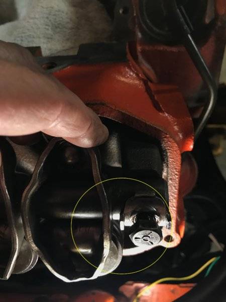

Pictures below show the gap I'm talking about and the wear pattern on the shaft - the rocker groove is not centered over the oiling hole....that doesn't look right.
Measured my parts - all mostly the same except the rockers: spacers = .200, hold downs = 1.475 & 1.025, rockers are close in width to the stockers at the top but they taper inward quite a bit near the part that would be contacting the spacers and hold downs ... taper shows pretty well in the picture. They all slide up and down the shaft (between the hold-downs) about .150 -see the picture- when tension is pulled on them (like the lifter/pushrod assembly). That doesn't sound right either... that would allow the rocker to wander back and forth on the rocker shaft during operation...
I think we have our winner - I think these rocker arms are my issue.

Been many years since I've messed with stock rockers but those just do not look right to me. Mopar Performance offered heavy duty rockers years ago but not sure if they still do. In your first post, 2nd pic, the far right rocker looks very worn which will allow the one next to it to be off center. Does that look that way to anyone else?

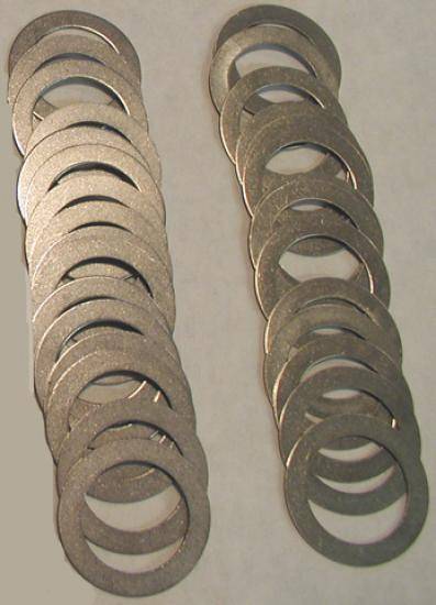

I'm know I'm going against the flow here, but I think you could shim those rockers (Hughes spacers) as long as:
a) everything clears the pedestals
b) the rockers don't have play on the shafts (I.D of rockers matches O.D. of shaft)
$8.50 - set of 50 (25 each .015" and .030")
http://www.hughesengines.com/Index/...Y2VycywgU2hpbSAmIEZhc3RlbmVycw==&partid=22138
Hughes also has several thicker spacers (.125"-.825"), but they are a little more expensive. Like $3.00-$4.25 a piece

It almost looks like they where cocked from preload or something and wearing on the shafts
Perfect example , look at his first post , second picture
Right Rocker - Far right one , bottom of rocker - The right side edge is perfectly uniform .
Left side edge is totally worn away
Now go to the same Right Rocker , however on left side of same picture .
The left side bottom edge is perfectly uniform , and the right side is totally worn away
Those are the same identical Right Side Rockers
They are garbage
