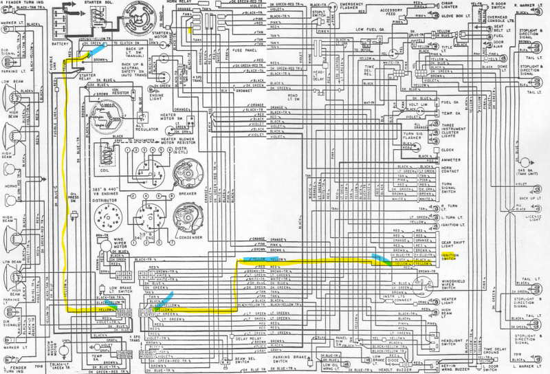

Alrighty gents...my problem is no power getting thru my start/ ignition switch on my column. Here's what I know:
All new harnesses in the column with a new switch
12v at the large red lead from the dash harness to the column harness.
12v making it thru the .connector at the bottom of the column and presumably up to the switch.
Put the key to START and no trigger voltage at the starter post....hence no cranking.
What am I doing wrong or what should I be testing next??

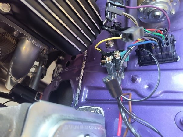

Check the connector at the bottom of the column. Sometimes the electrical lugs are not correctly locked & get pushed out of position....& no contact.
