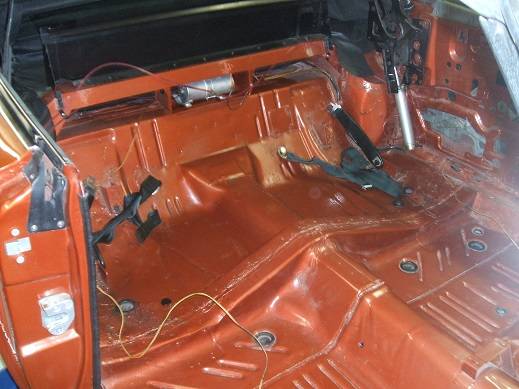

Pulled the interior out of the 70 RR I purchased late last year. Spent last winter fixing the steering and gave it a tune up then drove it around this past summer trying to get the "feel" of the car trying to get an idea of all I need to change and/or fix. My first Mopar so it is a totally different type of car then the GM cars I am used to when it come to the ride, body/interior and road noise, etc...
Floor looks pretty nice.....no rust at all. Not sure if any floor panels had been replaced in the past (no real experience on body work or welding) but will have a couple Mopar buddies take a look at it for me. Photos are right after I vacumed the floor but have not "cleaned" it with any cleaners yet. The doors and inside rear quarter panels look just as good. No rust any where. Lucked out.

The front part of the floor
Rear part of the floor

The floors look great. The 70 RR/Sat convertible is my favorite car ever. You're a lucky guy !!!!
Wow . . . those floors look nothing like my floors did when I got my car . . . wait . . . I can't say how they looked because there was quite a bit of missing ! ! !

soundhd, You have one good looking droptop 70 RR! A buddy of mine back in the day had one the same color and everytime i see one i always wonder if it could be his old ride (He's in Pa), I cant believe how good the floor is in that, you sir have a great ride there and good luck with your updates!! I am hoping to have the Wilwood disc brake's in my car, ive heard nothing but good about them..
