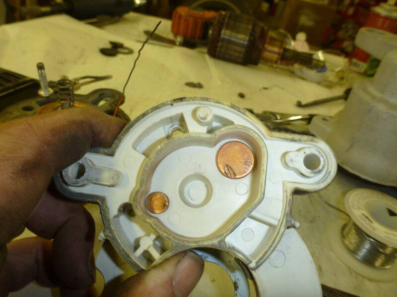

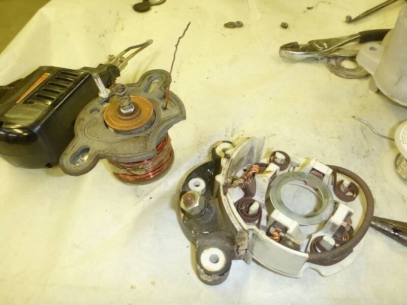

Contact ring in the starter solenoid is not contacting the battery stud when the solenoid is energized.
Right you are! I monitored the big terminal on the bottom of the starter - the one that feeds the motor. No voltage when the Bendix drive kicks in.
So the next step is to determine if this is due to no power on the input side of the solenoid switch, or if somehow the drive gear is being prevented from moving all the way backward. Note I had disassembled my previous starter (nearly new) and found nothing suspect in the solenoid contacts.
