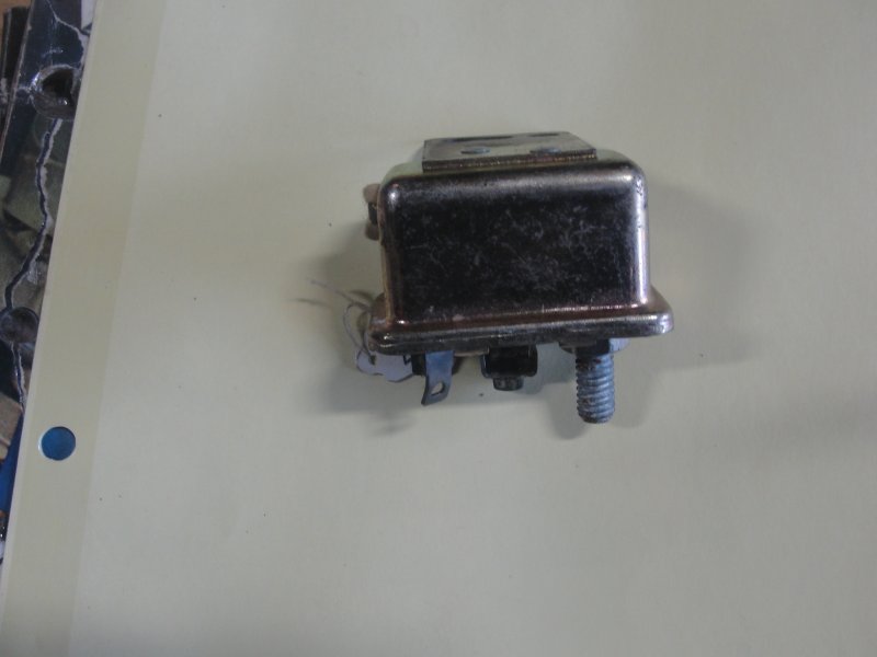

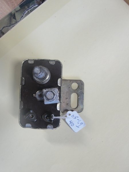

I made a mantenience on my factory relay before get a new one. Cleaned up the points with a sand paper. Last time was still working flawlessly.
Sad to say... :rolleyes:
But many of the universal starter relays built in China are junko..
There are still sources for the mopar OE parts, I went to 1 car parts
swap meet and 1 guy had about 20 of the mopar OE parts selling for $12 eaach.
He actually bought them through some miltary liquidation sales they
had at one of the nearby airforce bases they were closing. Apparently the air force
used alot of Dodge trucks that had the same starter relay part.
Just my $0.02... :thumbsup:
