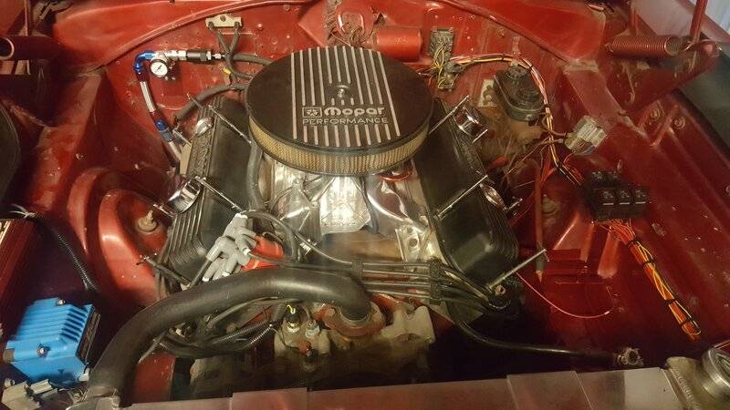

starter selenoid switch
lorny
6:34 PM
Oct 2, 2021
89
22
ottawa
66 coronet is it on fire wall near left valve cover
My 67 coronet has the relay on the firewall in that location
Often it's a burnt/corroded connector in the bulkhead connector.
Bad wire to neutral safety switch, check that. One of connectors on relay.
