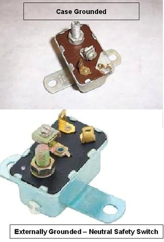

I have the same questions as mopar 3 B. Are you jumping the solenoid or the starter relay? If your jumping the relay and the car starts, the starter & solenoid is fine. The starter relay has to have a ground from either a neutral safety switch or there are some starter relays that got their ground from the case being bolted to the firewall. You said you have a 4 speed car. What is year & model your car?
