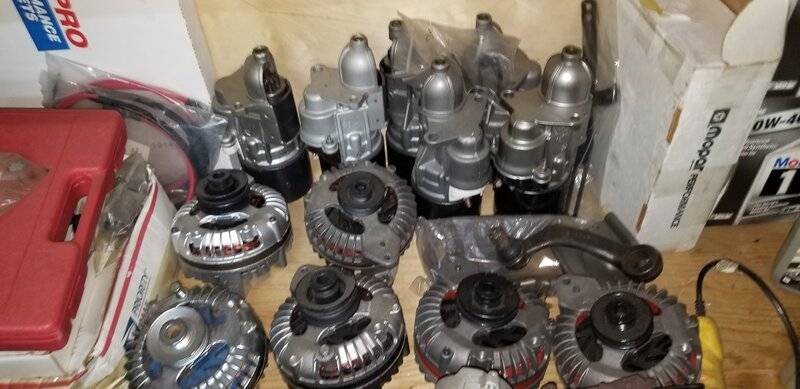

Anyone know where to get the old style mopar starter? Everywhere I go they all supersede to the new "mini" starters. Yes, I know it's probably a better starter, but there's something about the sound of the originals that's just right.

Ok, last vender craped out, showed a pic of correct starter in description, but what we got was the mini. Just for hoots, I brought in an old one that's been sitting under my bench for the last 6 or 7 years and put it on our tester. The SOB works just fine. So now the question is to mount it up, or try to get a reman. I don't have to worry about headers caging it, and the car's getting put up for the winter anyway.
Thoughts?
Mark
Clean it up, put it on and use it. Gives you plenty of time to shop.
Put in in and try it. Notice any faults it has, or if it works perfect. Then go from there.
