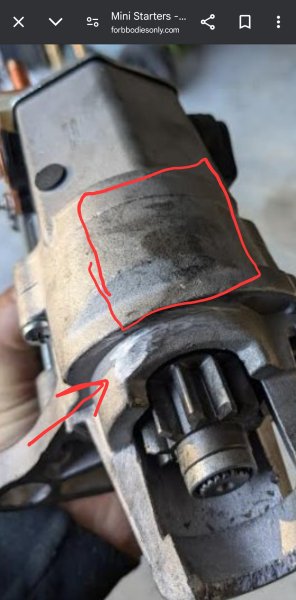

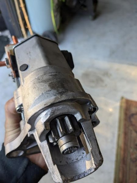

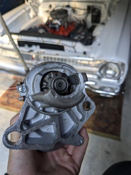

In my scenario, the nose of the gear housing (or whatever the correct name is) snapped off inside the bell housing. The starter could not fully seat against the surface in the trans, and it caused the snap. It did ~not~ interfere with the block, but it was very close so I just ground a little bit off as pictured.
After it broke, the starter could be reinstalled and tightened down fully flush and normal after the nose of the gear hosing snapped off, but now I am fairly sure the plunger is overextending (possible?) because after a few starts it would make an awful grind noise like bad alignment of the gears. Now I am going to need to buy another starter and do some grinding I guess.
Anyone had this specific problem? I want to confirm that the starter plunger/gear/etc can actually truly overextend and cause problems when this part is broken, I always assumed the copper plunger inside controlled that but the grinding noises make me think different. I have seen people have to grind for block clearance but not for fitting all the way in the 727.

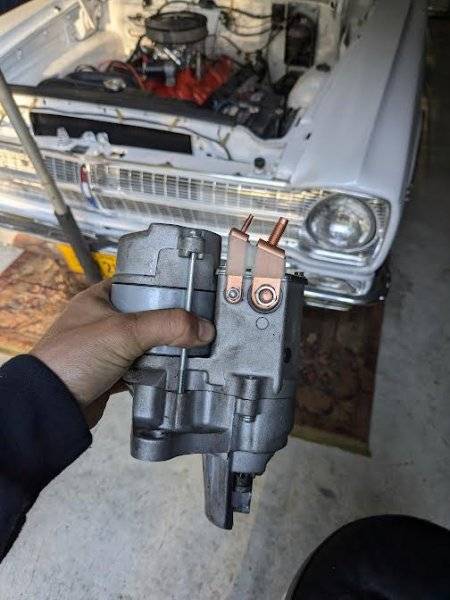

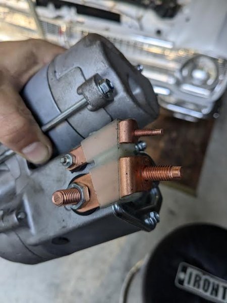

I will test fit the new one in a spare 727 I have on the floor of the shop to see if it bottoms out like the last one did. Final note, the $30 terminal relocation part off eBay works very nice, you just need to grind a bit off the large terminal post, it sits very close to the block

If I put another mini starter in I'd clean up the nose as pictured in @gkent's post. Had to do some wiggling of starter to get starter in the hole in trans. Casting flash and maybe not round enough to slide in. Nothing broke but could see it happen.

If I put another mini starter I'd clean up the nose as pictured in @gkent's post. Had to do some wiggling of starter to get starter in the hole in trans. Casting flash and maybe not round enough to slide in. Nothing broke but could see it happen.
This is what happened.
Sounds like block interference
Yes the nose has to be on it to align properly, hence grinding

I've never heard of grinding a 727, but the block is almost a guarantee. It looks like you were grinding in the wrong spot. It's the U pocket of the block that is too fat. Looks like you have witness marks in the picture. Look carefully on the block for rub marks
That "rubbing" at the drive gear is probably where the starter is rotating/jumping around because the snout is broke off. The snout locates/indexes the starter motor. Without the snout plus a loose hole at the top of the mounting flange the starter will flop around.
The issue was the broken snout.
The big question was, what's possible when the snout breaks.
This was info I was looking for. Thanks.
