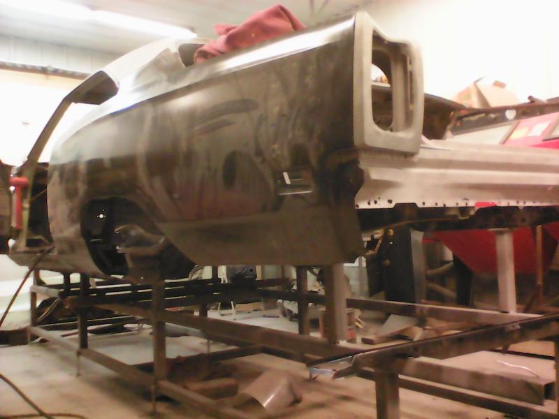

Brian[/ , thats pretty much were I started. I made a frame jig for mine. it doesnt really matter how you do it, as long as you have reference points and measurements before during and after the install. mark your floor body and stands, that way you know if anything moved. and dont move you stands or jig untill you are all done.I'll send a pic of the jig I made , it may help

IMG_20150201_160822.jpgyeah I have seen those pics of cars on the rotisserie torn apart also. they claim from what research I've done , that you install quarters with car in it's natural state,ie on wheels or on your jig so there isnt any sprung weight.I've heard of guys getting cracks in thier panels because they installed them on the rotisserie.anywho,,, here are my pics, if i want I can move this jig, all I have to do is crank up the jack bolts and move it. however I dont /wont move it untill its structuraly sound. I have the floor marked with tape around the jack bolts so I know if anything moved while I'm working on the car. hope this helps you out

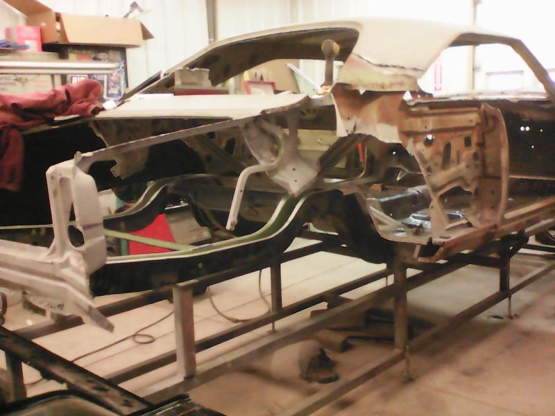

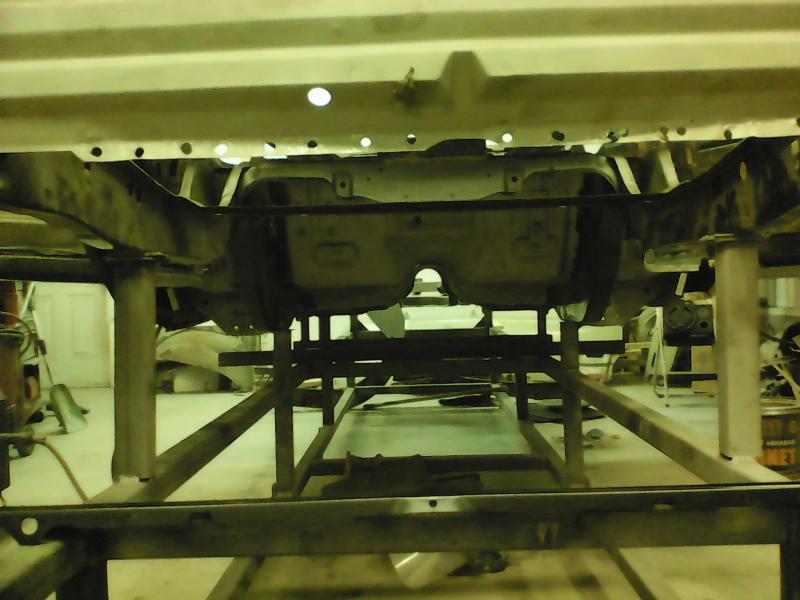

IMG_20150201_160839.jpgheres another

Nice frame jig for sure, I see why you wanted a thorough one like that being so far torn apart. I believe things would get funky with a car hanging off the end of the frame rails and tearing it apart and welding it back together! Hopefully I wont be tearing into mine that far and need quite that extensive of a jog, but ya never know! I'm thinking you added two sets of horizontal rails because of the overall height and concerns of the "racking" with what would have otherwise been long vertical supports.
Well the two horizontal bars help stiffen the jig up, it also works to get the car up so it's easier to work on , so yes it makes the vertical bars shorter . I built my jig for around 400 with wheels and all
