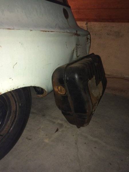

I am going EFI on my '64 Belvedere wagon and will need to have a custom tank made. I would like some pics of a wagon tank to be able to send to shops to see if they have a template they can use. I am trying to avoid dropping my tank just for pictures. Does anyone have pictures of a tank?

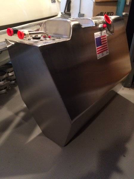

Been there, done that. Call Rick's Tanks in El Paso, TX. They have my wagon tank from a 63 Plymouth they used for a core to make my custom tank. Expensive and you will still need to figure out how to install the filler neck as I've not gotten that far yet. This fuel cell tank is about 7/8 the capacity of the original tank and you'll need to shim the sides and bottom where the strap holds it with 1/8"-1/4" thick masticated rubber (trucker mud flap material)
Been there, done that. Call Rick's Tanks in El Paso, TX. They have my wagon tank from a 63 Plymouth they used for a core to make my custom tank. Expensive and you will still need to figure out how to install the filler neck as I've not gotten that far yet. This fuel cell tank is about 7/8 the capacity of the original tank and you'll need to shim the sides and bottom where the strap holds it with 1/8"-1/4" thick masticated rubber (trucker mud flap material)View attachment 657077 View attachment 657077 View attachment 657078
Thanks so much! I did reach out to them last month. This still mounts in stock location?
