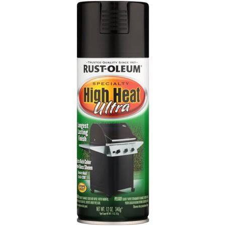

I've been useing Rustolum high heat barbeque for touch up. Comes in black and silver. They have an "Ultra" out now that dries faster. I don't know how it does but the regular works great. Won't burn off.
