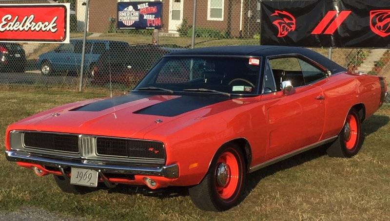

I used the Wheel Vintiques from Summit Racing on my Charger as well... No complaints. 15x7 all around with 4.25" BS 255/60/15 Redlines on all 4 corners

Looks great and nice color match! We'll check out those Vintiques when we take in this new Charger project. The new rotors and alloy ion wheels of the F150 Ranger arrived so we can clear a spot for the Charger in the garage this weekend.

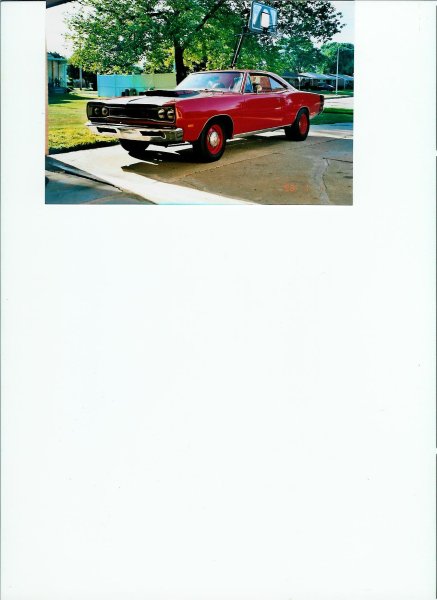

I had a local place near me called Weld Craft widen some old factory 15×6 wheels for me to 15x10's. I love the dog dish look on some cars, but not all. Same wheels and tires on my Coronet R/T and Charger R/T S.E. I liked them on my Coronet, but not on my Charger. They didn't suit the Charger for the poverty look being a loaded R/T S.E.
I now have them on my Roached Runner (repainted) for the "dork dish" look.
