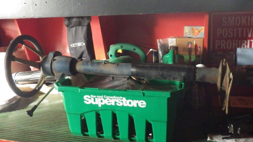

Thanks to all of you for the information. I went and got it today and will be rebuilding it over the winter. It is in fair condition, nothing a little paint and my time can't fix. Thankfully it came from a Charger with manual steering and should be just fine.

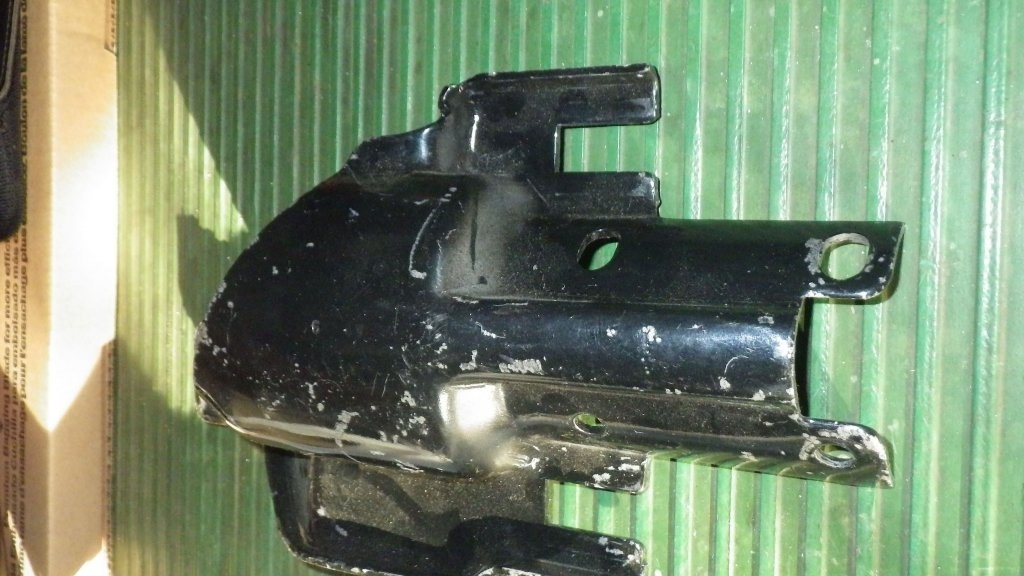

That's what i paid CND$100 - also picked up a spare mounting bracket, (refinished in black, but missing the white break-away capsules and mounting hardware) for a $20 bill. If anyone knows where the plastic bits can be ordered from...please post or message me. I am in Alberta, Canada. Thank you in advance for any leads.
