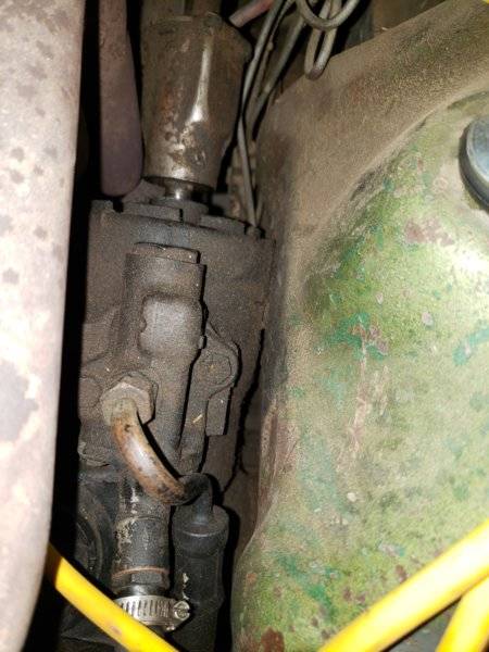

Here's a picture of the steering box, let me know if you guys think it looks about right. Thanks.
Doesn’t look right to me.. I’ve got a 71 Charger, and I have a lot of space between the gearbox and inner fender. Yours appears to have no space at all.. Is a 70 GTX, that much tighter??
