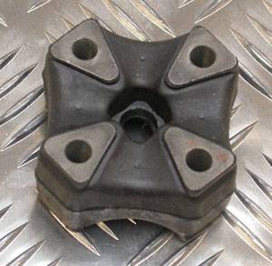

The biggest issue I can think of would be the "puck".
I have a thread about that, using an actual hockey puck.
There is only one (maybe two) source for a correct repro 73 puck and they are very pricey (like over $100 IIRC).
The 74 and newer style is available down the street for $15 or less.
Ah yes, the hockey puck solution, and here is the compare picture of my options with the original, a steel one, and the hockey puck with steel sleeves. I have been using the steel one, it only cost 45 bucks but that was because I had to have a machine shop drill the larger holes for weight reduction.
I thought someone tried that LR part and it didn't fit.
I haven’t mounted mine up yet but I see no reason why it wouldn’t work. It’s a little thicker than stock but the pot coupler should more than make up for the difference. You may need new hardware, the lugs aren’t counter sunk. Or you can take care of that in two minutes on a drill press.
Those countersunk Philips head "bolts" and super thin pinch-lock nuts are a royal PITA to work with.
I replaced mine with 'regular" bolts and jam-nuts.
MUCH easier to remove/install.
