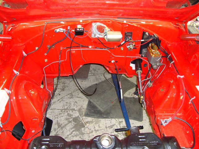

does anyone have a detailed picture of the bottom steering column where main steering shaft comes out of tube I am trying to see if there is just a dust shield or bearing at the bottom of the steering column I need to see if I am missing any parts.Any help would be appreciated. thanks Don
Not a close up but it may give you what you need.
Hey, yeah!! Sure does. Is that a RR too?
Looks like a Hemi master cyl for the Bendix 4 piston disc brakes.
Thanks alot, between my shaft and tube I do not have a dust shield or bearing but between the tube and outer housing I have the white plastic bearing is this the way yours is. I cannot tell for sure from the pictures. thanks Don
The bearing, which is supported by the plastic holder rides directly on the shaft.
