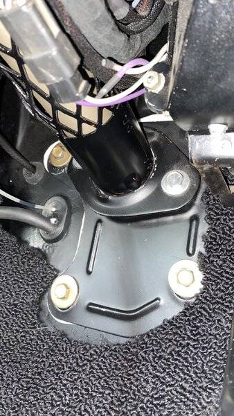

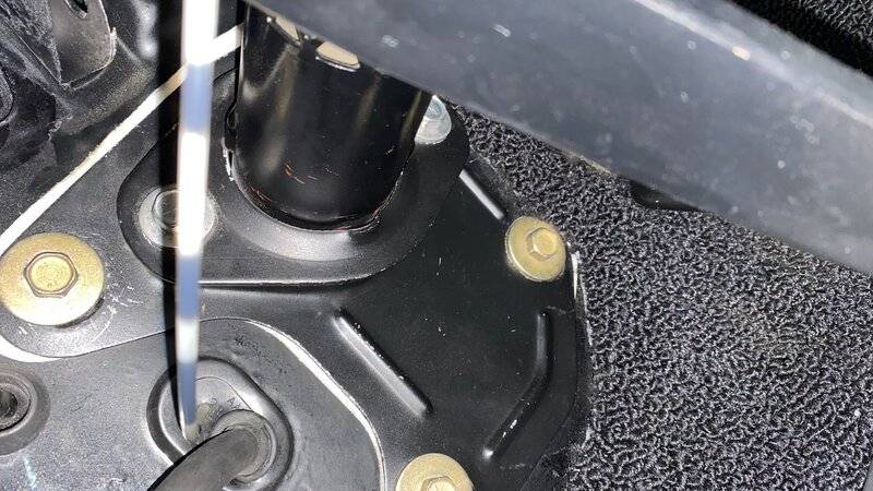

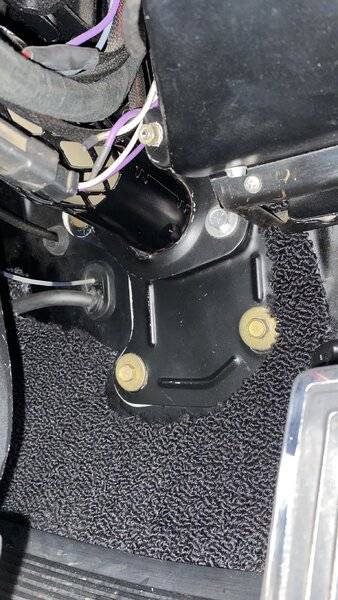

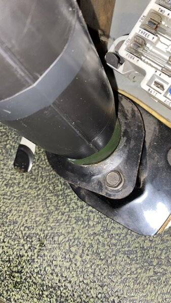

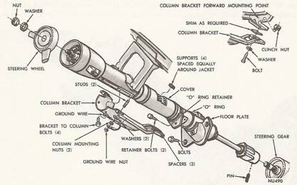

I know only on my 73 station coronet the adapter ring and column it self match exactly and I not have any play in the column if I touch it and try to shake ....

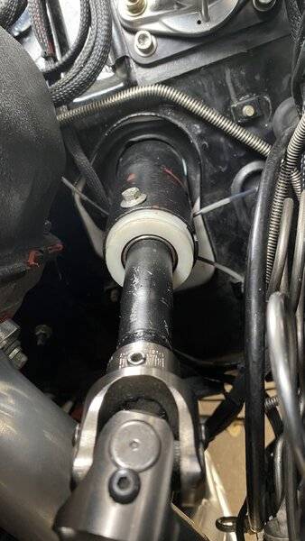

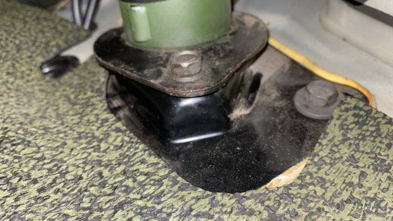

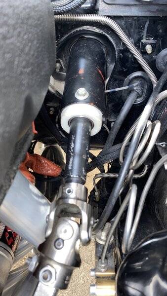

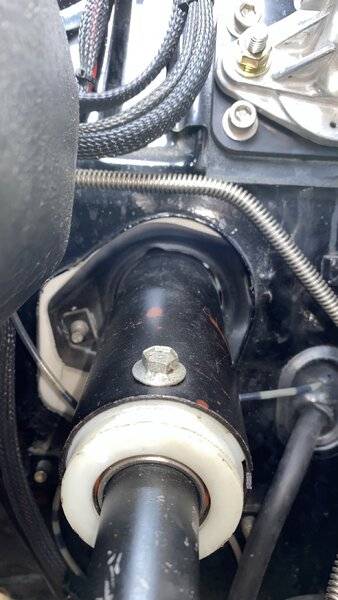

If I touch the column in the motorhome near the firewall and try to wobble it waggles a little , maybe this is the reason why I feel vibrations in my steering wheel about 65-80 miles if I cruise in this speed range . On full throttle trough this speed range to 100 miles I not feel it, because everything under “ load “

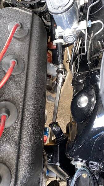

Up to the flaming River coupler everything is no wobbling or play in it , only when I touch the original shaft , and shake it the steering column up to the steering wheel wobbling
