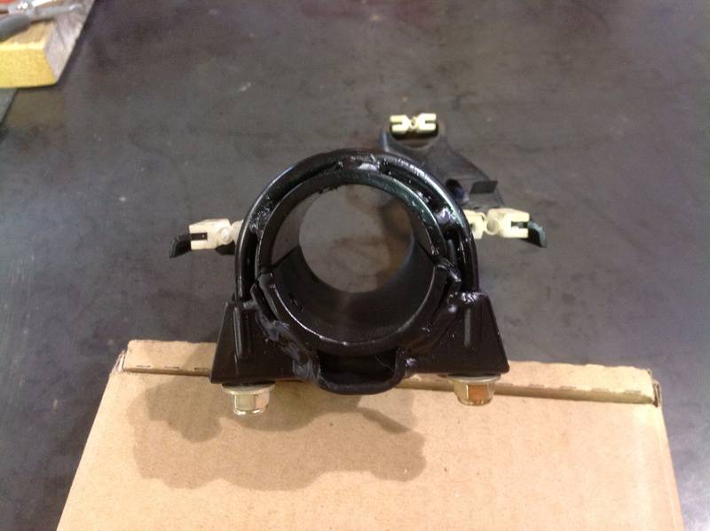

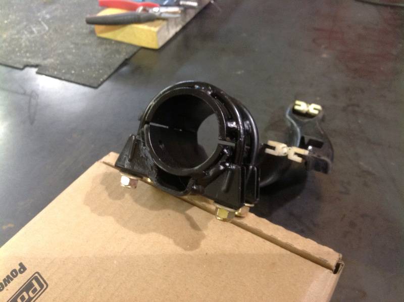

I just did this mod on my 70 satty. The firewall penetration is the easy part. just replace the original rubber gasket with one with a 2" hole. On the end where the factory column bolted to the dash bracket, I took a piece of 2" ID tubing about 4 inches long, split it down the length, welded half to the bracket, and used the other half to clamp the column with. I have some pics somewhere if you are interested. Worked great and was cheap to build

I forgot to get one of the gasket, but here are several of the main support. Just some 2" ID tubing and two clamps welded on. Held it very tight in mock up. Hope this helps. I really like the tilt column from FR. I am 6'5" and it sure helps
oh yeah, be sure and tap a hole in the tubing for a set screw to go into the column for a good ground.
You can see in the second picture I used one of the original column mounting bolts for he set screw/ ground

awesome, thanks, mine is now installed i used factory top bracket a little different to that but works and for the bottom i pulled the egg shaped 2 bolt plate off and made one with a smaller hole and stitch welded it to the column it is all nice and tight now works perfect thanks for the help
