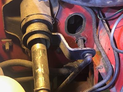

This does happen. The lever on the column....

Is somewhat sensitive to alignment. The steering column has that mounting plate that attaches to the firewall from the inside.

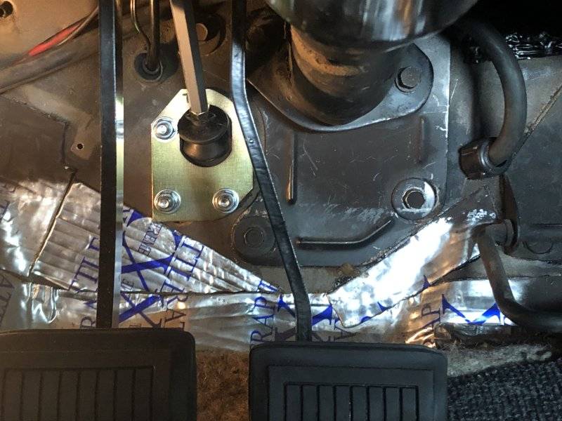

That plate has large holes for the mounting bolts. The large holes allow for a wide range of alignment and if you're too far up-down or side to side, (even diagonally) The lever on the column may not engage park or not engage 1st gear due to it being "out of center", so to speak.
You can try loosening the 4 bolts and shift the plate and column around. There is also the linkage underneath that can be adjusted a bit to get you there. Good luck....report back.

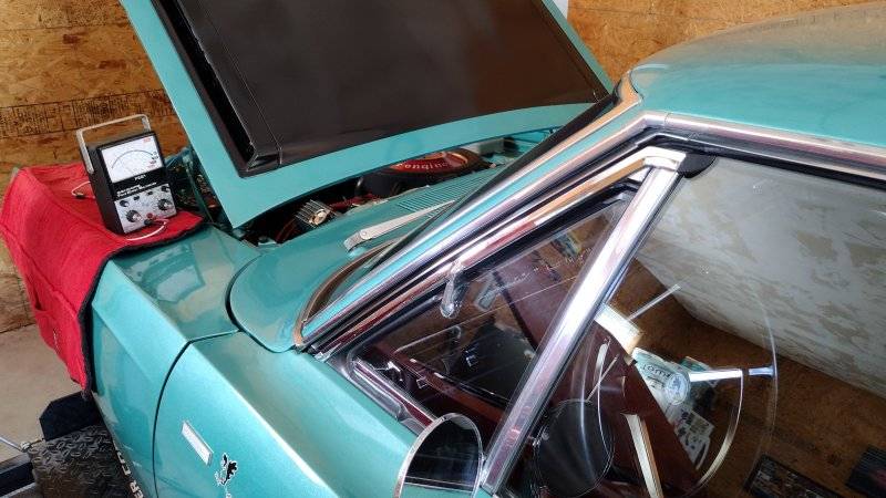

I'm using a ohm meter and measuring continuity to ground at the starter relay wire. This is the connection to the neutral safety switch in the transmission.
I cycled the shifter from Park to Reverse and Reverse to Drive and then back to Park
Every time continuity was less than 6 ohms in Park; even 20 out of 20 cycles Park showed continuity to ground.

I'm measuring 5 or 6 ohms which is expected as wire lengths add to my measurements.

I agree let's not debate. If you ever find the time measure your circuit. You will be surprised. I've seen neutral safety switch continuity as high as 20 ohms and the car will crank.
If I were troubleshooting this with a test lamp I'm sure it would glow bright when the shifter is in Park or Neutral.
Again let's just say I am measuring continuity and disregard the ohm measurement.

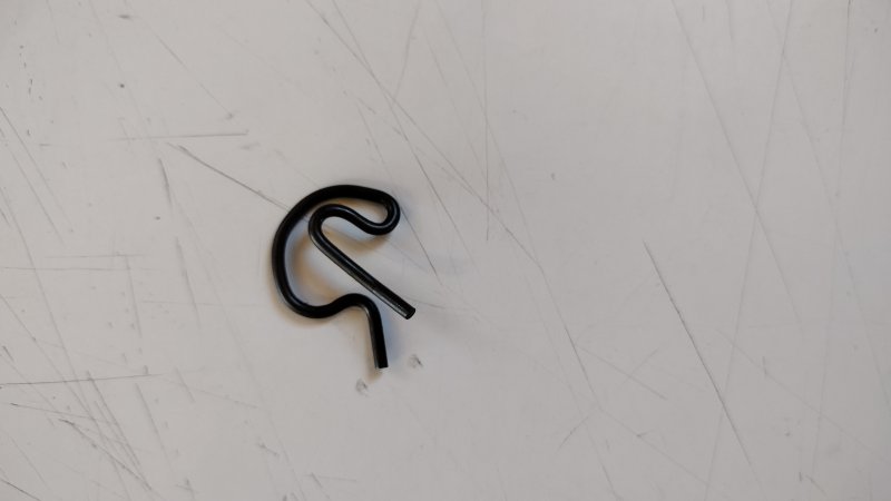

I like to follow up on my threads; in conversation with a fellow Mopar collector and former professional mechanic about this issue he asked if my "shifter clips" were keeping the linkage tight.
"Shifter clips I ask?"

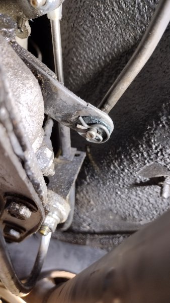

Then it occurred to me that I twisted and deformed the clip on the column linkage connection. Also, previous owner had stacked washers at the transmission selector and a cotter pin was in place.

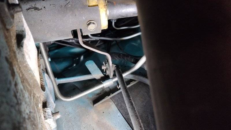

Replaced two shifter clips and used a single washer. Adjusted the linkage.
I could tell a difference immediately when I shifted out of Park. Shifting from Reverse to Drive was also less clunky and sloppy. Each selector detent seemed solid now.
Drove around and made 6 stops over a hour and a half period. Car started all 6 times in Park. Time will tell if I fixed the issue, but it sure seems more like normal now selector wise.
Replacing the bushings and clips in my shift linkage really tightened things up, to the point that getting the column detents and trans detents synced up became kind of a pain. I finally got it right by putting it in neutral and making the adjustment. Now the pointer accurately aligns with the selected gear and the low and park detents effortlessly drop in.
Make sure that rubber bushing in the column linkage lever has the brass sleeve in the middle of it
