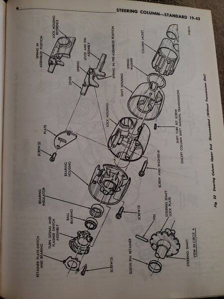

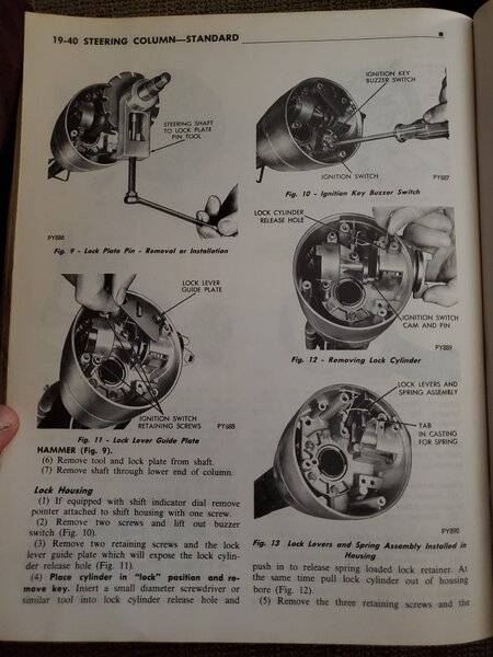

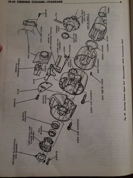

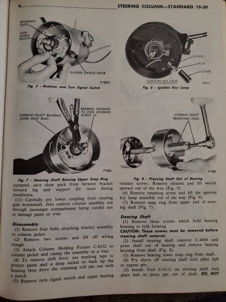

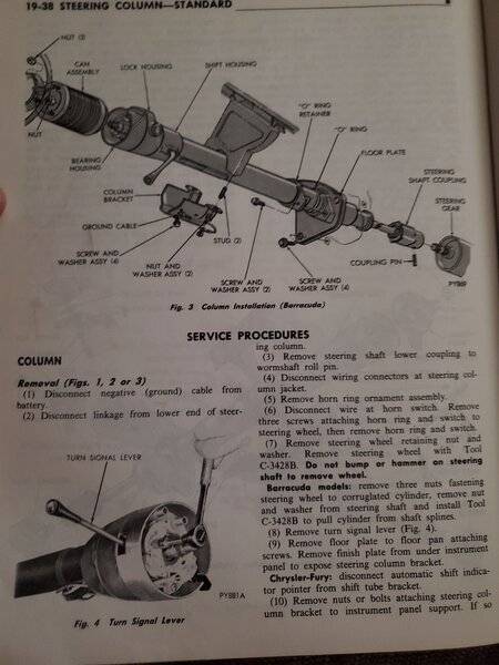

Hey y'all, I am new to the forum. I just bought a 73 Charger Project Car and I'm tying to get into the steering column to fix a wiring issue. How do I go about getting to the turn signal and ignition switch in the column?
Gotta pull the steering wheel off. They are under there.
Welcome from Michigan, the Motor City! I would recommend a factory service manual young man. Great to see a young person interested in these classics! 440'
I got the steering wheel off, but the part that that it attaches to is still in there and I can’t figure out how to get it off.
There should be a couple screws that hold the turn signal switch on. Take your time looking it over.
As said above, a factory service manual is a HUGE help.
Here's pics from my 71 FSM.
Hope this helps.
Great info here on this site and a lotta help available, my recommendation, if this is your first Mopar as said, go slow and take phone pics for reference, they can really come in handy after a nights rest ! Possibly look for a snap ring around the shaft after steering wheel removal!
