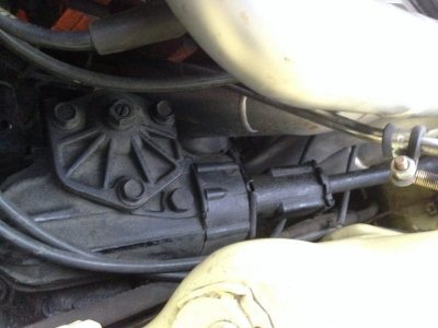

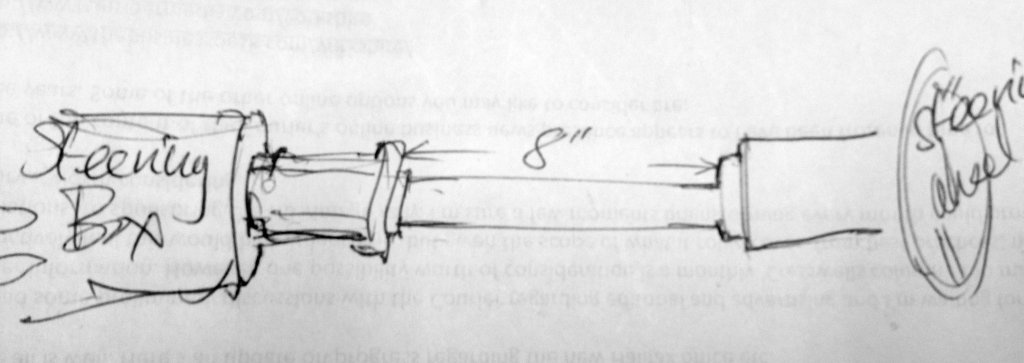

I've manual steering on my 68 Coronet. I'm going to fit a Flaming River steering box. But I need to be sure I'm asking my supplier here in the UK that I'm specing for the right parts, as the shorter power steering shaft could possibly be fitted to my car. So i'd be grateful if one of you experts can verify either way please! Hopefully this photo and my garage doodle gives enough info, I'm certain it's all manual, but I need to avoid an expensive mistake. So, have I a manual or power steering shaft?

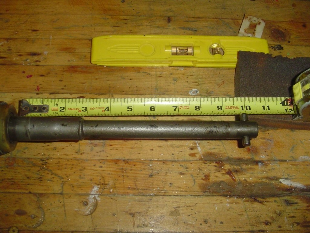

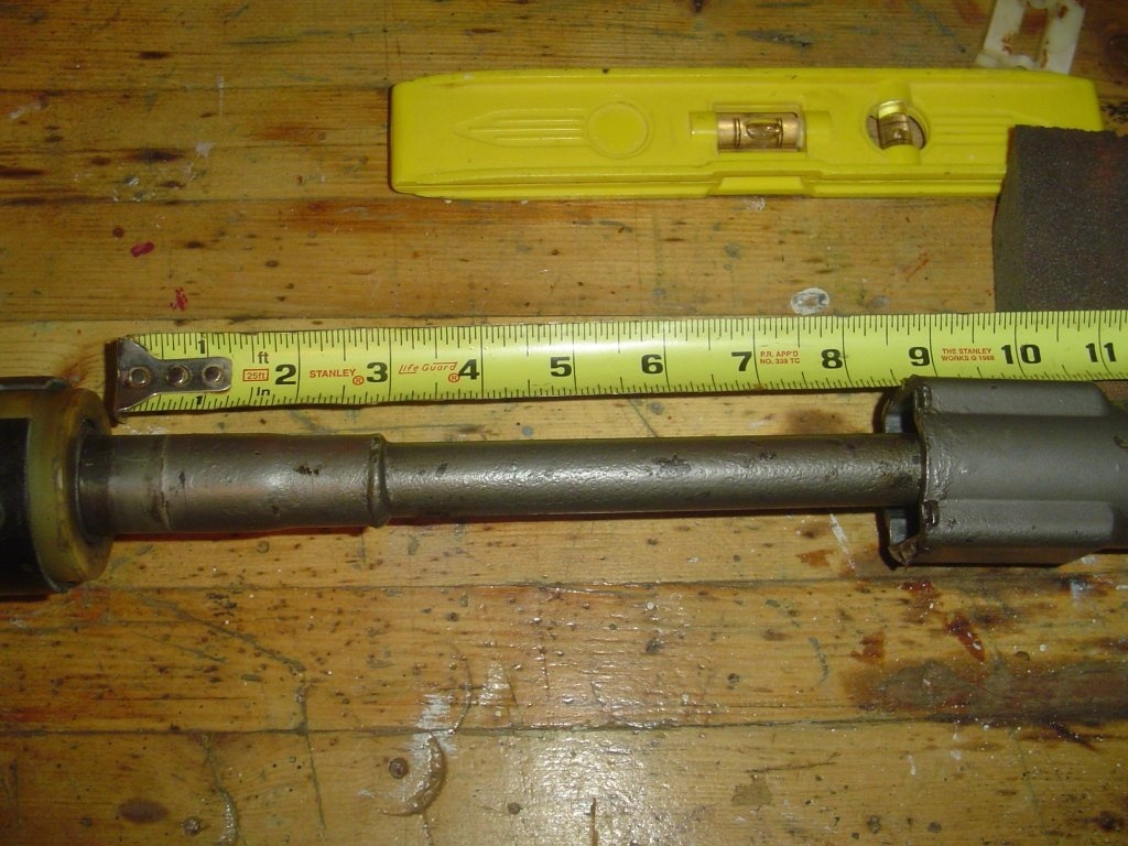

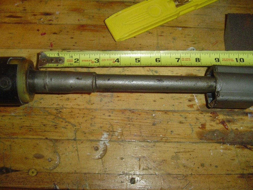

That's definitely a manual gear box, as I'm in the process of rebuilding mine right now. It's a 1969 Roadrunner so we should be the same in dimensions. Here's a couple pics hope this helps.

Great, many thanks Darc, I've definitely got a manual-length shaft :thumbsup:
