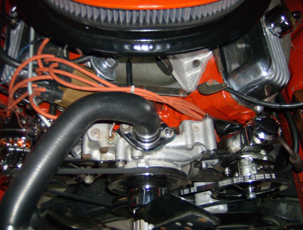

That pump picture is one of my cars, I posted it on a pump topic in the past, and its a federal with no tapped hole at the pump shaft. Trw's have Trw cast in the pump right at the pressure port.
That picture is a late 68 pump in case you wanted to know.

Rrunner, I found that picture on the ICCA site years ago, from their engine compartment pic's....
