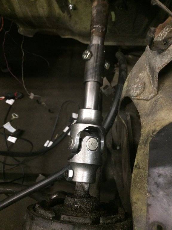

I should have called him, but I had already ordered the steering stock and coupler. So here is what I did...
Pushed the steel pin for the old intermediate shaft joint out of the steering shaft
Cut a 79mm piece of 3/4" smooth steering shaft to fill the gap left
Drilled the coupler for a bolt to couple the steering column to the new shaft through the original steel pin shaft.
Mocked it all up, now it's ready to be welded. (I will finish weld it once my full swap is done)

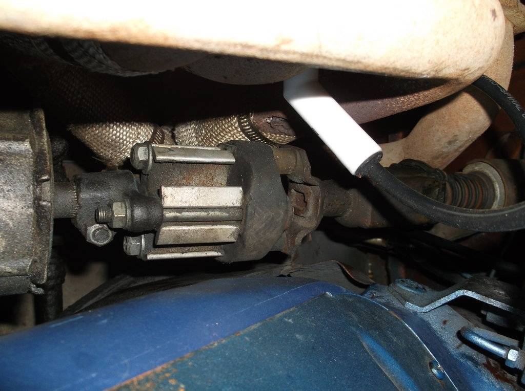

Speaking of steering shaft being too short.....I need a pointer in the right direction. I want to put the factory power steering back in my butchered car badly. Where did you get that steering u-joint from? I can't find it anywhere; Rock Auto, Advance, Napa...etc. I will attach a picture of the home made setup I have with a spacer that looks like it was from a Flexlite style cooling fan. I have 2 power steering pumps and a rebuilt factory box. Question 2 is can I swap the box without pulling the motor out? I'd like to do it without having to weld or cut anything. I wonder about clearance on the headers also. Any tip would be greatly appreciated.

That setup looks like your death, not too far off.
You ain't kiddin! I am not comfortable with it at all so I take it pretty easy. I have no idea where they got the parts from to do it. I met a guy who raced a 1963 Dart with a Hemi in it and part of his home made front end had universal joints from a socket set welded in. He ran in "C" Gas if I remember right. The car was called "Little Iron" I believe and I never saw him lose a race. Car was fast as hell !!!
