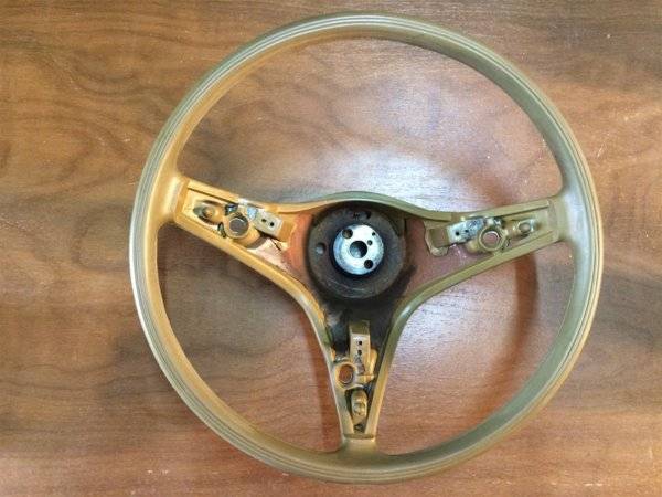

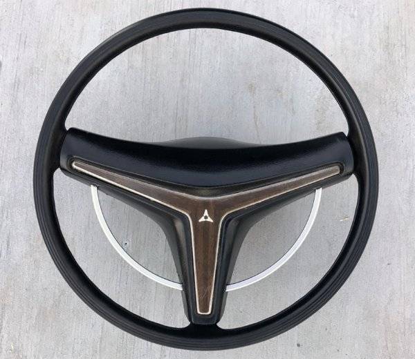

I used Duplicolor Vinyl and Fabric coating on my steering wheel and it came out very nice. How well it holds up is yet to be tested as I'm still in the restoration phases. I changed from gold to black color so it took a LOT of cleaning and several light coats of the coating but the result was worth the investment. Here are before and after photos.

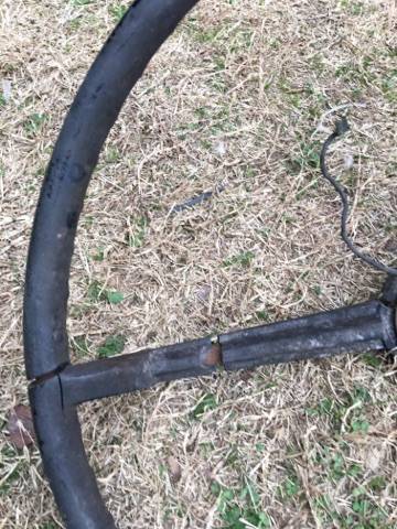

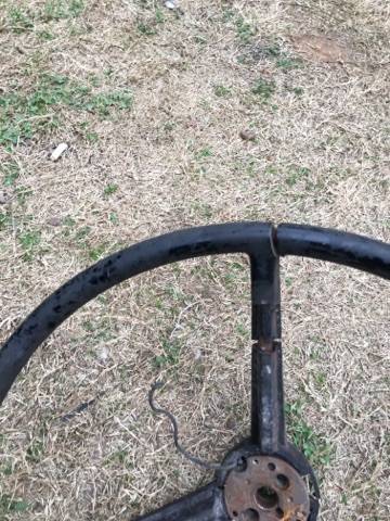

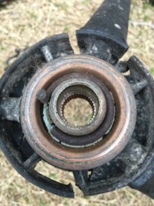

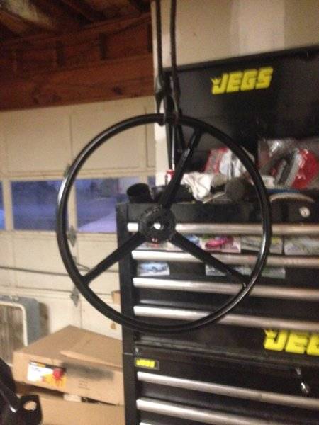

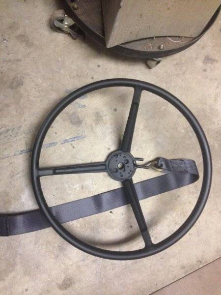

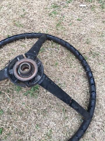

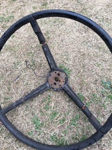

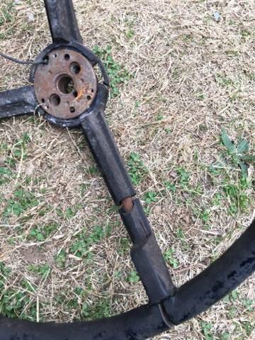

This is the wheel I did. Nothing special as far as paint. I used Por15 epoxy putty but kinda did it the same as the video above.
IMG_0684.JPG IMG_0685.JPG IMG_0686.JPG IMG_0687.JPG IMG_0688.JPG IMG_0689.JPG IMG_0690.JPG

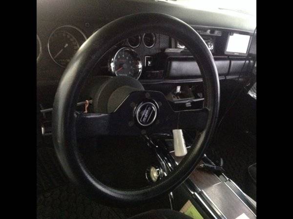

Might be time to consider a wheel of your choice. If driven daily, nice to have less dish and better grip. This is a Momo Johnny Player Special given to me. The Grant GT cheapie that preceded it was fine too.
