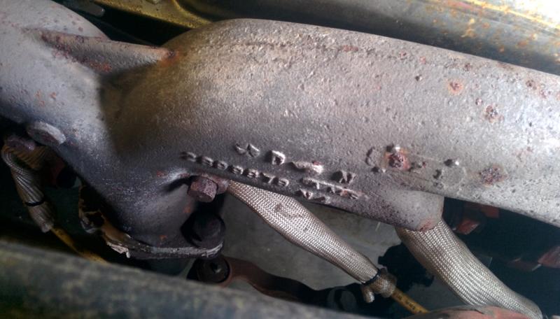

Hi all. Thanks for the responses to my first topic. Now that I've decided what to do I was trying to see how I can easily correct the steam locomotive impression the car is doing. I was told the manifolds are cracked so I was looking at the part numbers and the driver side doesnt seem to match anything i can find on the net.
I don't have the room to install headers and the shop refused to do it after they saw the rotted out frame rail but its not really drive able. Additionally if its going to cost me 100 dollars a tow back and forth trying to find a place to do the work then not much is going to happen I'm afraid.

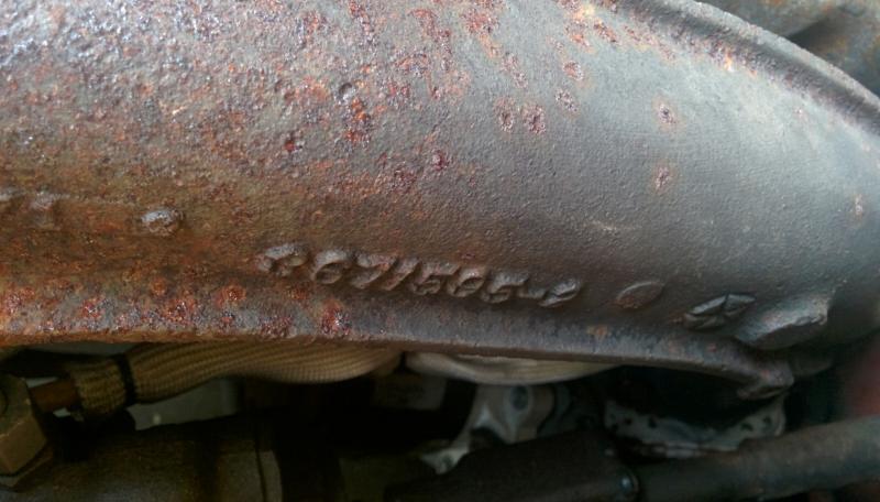

Any ideas? Passenger side makes sense.. I found others on ebay and around, but driver.. not sure about that number? Looks like 671595-2 to me and that lip on it doesn't match the pics I see of HP manifolds for sale.
The date on the driver side looks like 8 13 71. I think. its rusty.
Passenger Side
Drivers:
The number is 3671595-2 which is 73-74 B Body.
Correction.. its supposed to fit 72 400 cu also.. i guess its just got a really bad crack somewhere.. I dunno though. I will have to pull them both then. Thanks.
A crack should be easy to find. Feeling around (with leather gloves) could locate the crack. If it's that loud at idle, pulling plug wires one at a time until it goes away will narrow its location down. Also, is it possible that someone put gaskets between the head and manifold and it has blown? It should seal fine without any gaskets.
