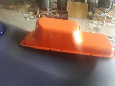

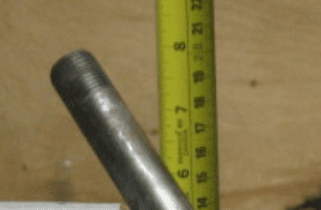

The engine is a 66 casting with W 1 on the top pad and no other numbers. It was in a 70 GTX with a 9 quart pan and appropriate pickup. The stock Hemi pan I have came with a windage tray and a 440 3/8 pickup. Maybe I need to know the difference in the pans before I buy a pickup. I have spent two weeks jacking around with Jegs with 2 Milodon pickups that look nothing like stock Chrysler, yet the picture shows what looks correct to me.
Post a pic of the pan and the 3/8” pickup tube you have.

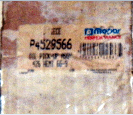

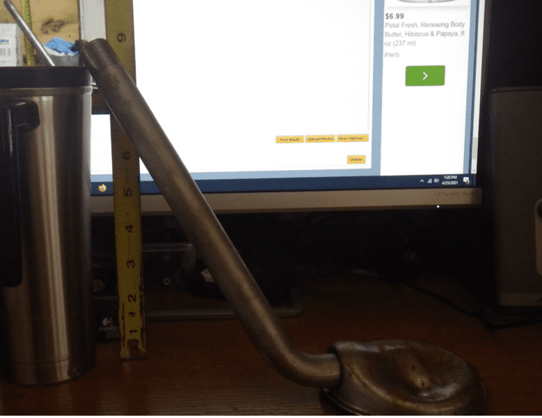

This is what I'm looking for in a 1/2" tube.

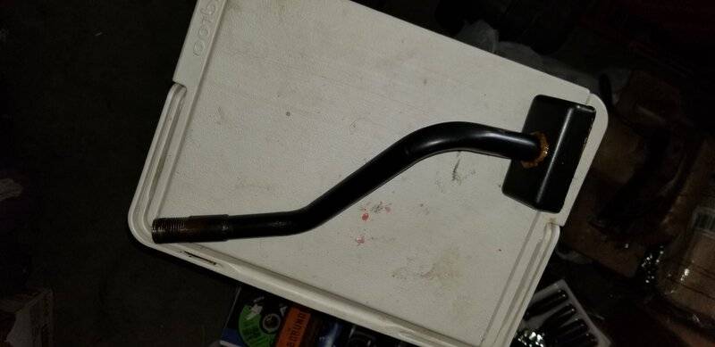

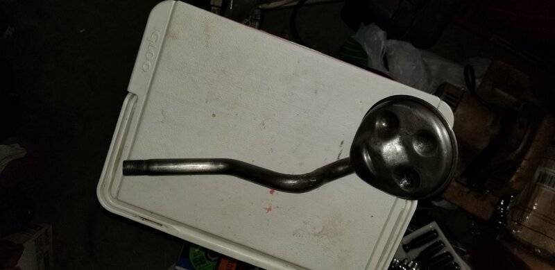

This is what was in the engine with a larger pan.

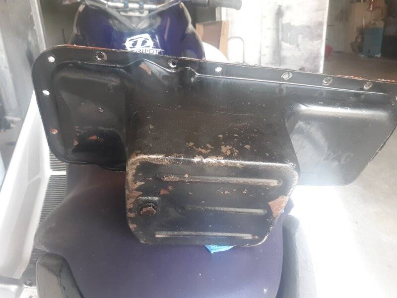

The pics helped Jerry so you have a 66-69 pan? Disregard the pickup just trying to see what pan you have.
Isn't a website with oil pan dimensions? I've forgotten which.
I will have to get that picture later, as I have taken the pan to my shop in town with the engine, K frame, belt housing, transmission, and driveshaft. If memory serves me that may be the pan I have.
Apparently I have a 70-71 style pan.
Here is what was on the engine.

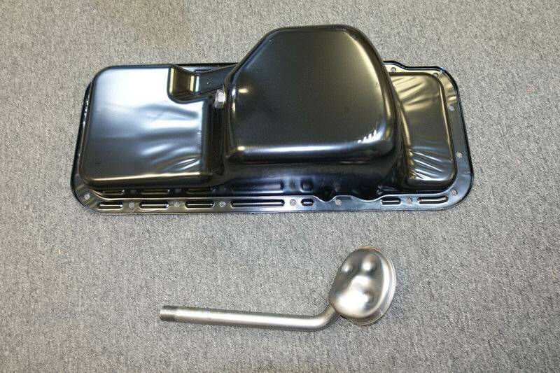

yep that’s a 70-71 pan and the straight style 1/2” pickup is the one you need

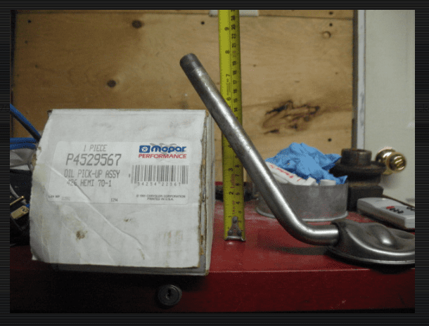

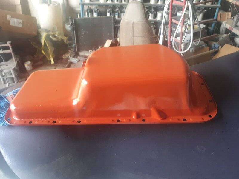

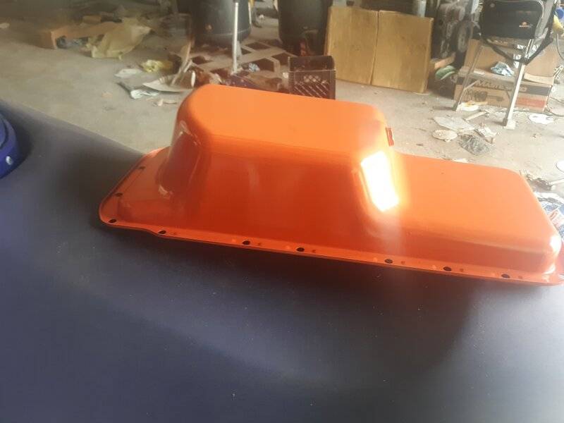

Hold tight there a minute. The 70-71 looks 3/4" inch shorter than my 66-69.
From another post.......
Mine
