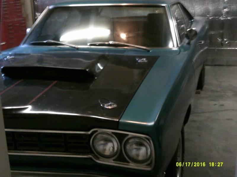

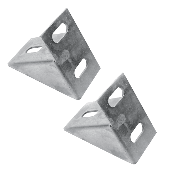

a real 69.5 A12 RR/Super Bee 6bbl/six-pack hoods
has/have no springs or latch
it has 4 hood pins & lanyards 2 front off the radiator support outer sides
& 2 rear with a mounting plate the goes where the hood hinges would have
albeit this is on my 68 RR, they never came on them
it doesn't stop you from installing one on them

rear pin mounts, also from Year one
