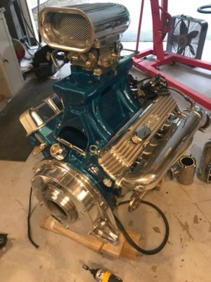

I used the same topend combination on my dragboat engine. (it's a 383 stroked to 438). I just checked a 1970 style factory VC and "no". All the aluminum rockers are rather bulky. But there is hope. Check out ::
https://www.medicemfg.com/products_get.php?c=Valve Cover Spacers - Mopar
They sell VC spacers. I'm doing 440 build for my car and would like that stock/stealth look if possible.

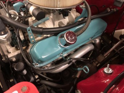

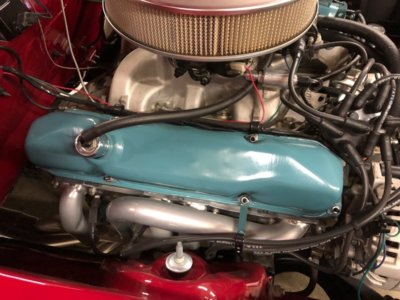

I’m running stock valve covers on my stroked B engine with Crane roller rockers on Edelbrock heads with a .501 lift Comp cam. Baffles are still in the covers, no interference.
Wow! Cool.... Which covers if you dont mind me askin?

Just stock covers from a 69 383 Polara. I’ll see if I can get a picture later. I did add a piece of tubing to the right side cover so that I could use the earlier PCV.

A pic would be cool to see. Thanks.
