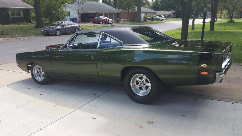

My car has a bit over 500hp, but will not be drag raced, or auto crossed. (Ok, maybe a drag race or two). Mostly just a cool old car I can cruise around in. I can spend more $$ if needed to get a good braking set-up. Wilwood would have been my first choice, as they are very popular, and look cool. I thought it would be an upgrade over stock system. Just starting to think that while the Wilwoods and others may be great for racing, is it really what I need for my car?
My car has a bit over 500hp, but will not be drag raced, or auto crossed. (Ok, maybe a drag race or two). Mostly just a cool old car I can cruise around in. I can spend more $$ if needed to get a good braking set-up. Wilwood would have been my first choice, as they are very popular, and look cool. I thought it would be an upgrade over stock system. Just starting to think that while the Wilwoods and others may be great for racing, is it really what I need for my car?View attachment 882135
