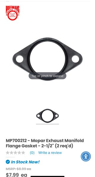

Is this the part I need? I realize from the feedback and reading in other threads in this forum that there is no gasket between the manifold and the cylinder heads. I may replace both sides if it’s only $8 per gasket. Here’s the link: is it an exhaust manifold flange gasket I need?
https://www.classicindustries.com/product/mp700212.html
Look around the exhaust manifold at night with all sources of light off. You might be able to see a dull orange glow each time you hear the click. Do it at idle and around 1,500(?) rpm... something above idle speed.
I hope you don't have a cracked exhaust manifold.
