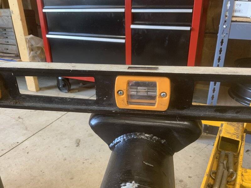

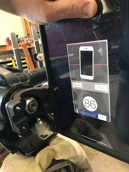

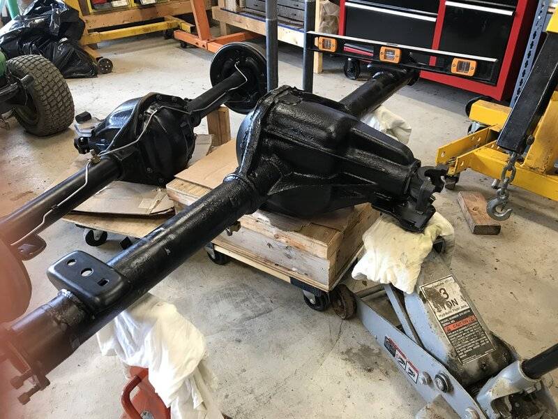

I recently downloaded an angle finder app on my iPad and used it to measure my pinion angle. It was spot on. I put my iPad on the flats of the pinion yoke. Keep in mind my diff is upside down in the pic with the perches level to the ground. It’s pointing 4 degrees nose down. From 90. So when it’s installed, it’s 4 degrees nose up in relation to the perches per DR Diff.
View attachment 947574 View attachment 947585 View attachment 947597
I use an angle finder app on my phone too.
