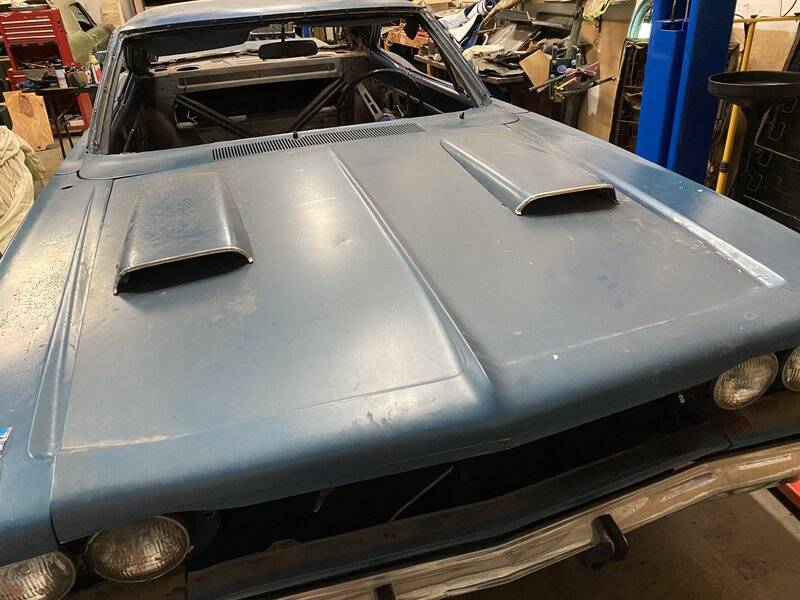

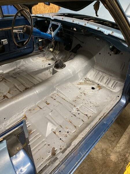

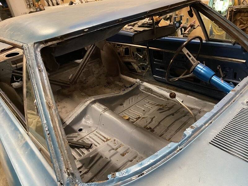

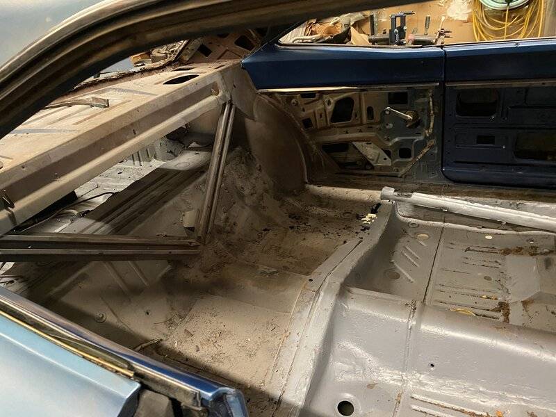

On her way to get lots of metal and body work done. In the meantime I’ll work on getting the dash and heater ac box restored. Also working on exterior bright work, getting bumpers sent for re-chroming and lots of misc. It’s a process and I’m enjoying it.

69 bee 383 4 speed.... original white ?...with ramcharger Hood
That thing looks pretty darn solid!
B7 Blue, blue interior. Black vinyl top, black stripe. It is 4 speed and factory air. I don't think the hood is original, there is not an N96 on fender tag. The ram air will not fit underneath because of air compressor, don't have it anyway. This hood is in excellent shape and I am debating going back to the bubble hood for originality, as trans, engine, vin, and radiator core support are all matching #'s. I would consider a trade but only if in excellent condition, or with enough boot to make it excellent...
What you see in the pic is very solid, floors had been replaced at one time. The rear seat area, trunk pans, supports, quarters, etc I have purchased from AMD and will be replaced. The previous owner, now deceased, repainted the engine bay, rebuilt the motor and and trans, new master cylinder and brakes are good, etc. Still lots to do. Interior I have the seats to be recovered, but pretty much need the rest of the interior; door panels, kick panels, arm rests, etc etc.
That's going to be a really sharp looking car. Don't see many in B7.
