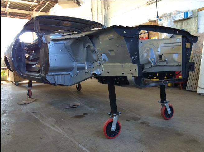

Here is my Charger getting ready for the blaster, US Car Tool (pricey) but convenient for me.
