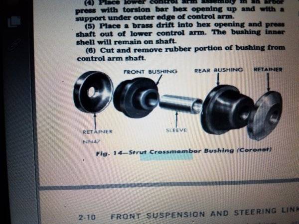

Hi All. I found this diagram in the service manual. I cant find a rubber kit that comes with the sleeves. Can i buy them separately? Do I need the sleeve? I thought the Moog kit would come but it does not.
Trying this Moog kit K7026. Should be here tomorrow. K7016A is not a complete kit.
Let me know if you still need them I’m pretty sure I have the sleeves in my shop. I went with qa1 adjustables so I did not re use them. You can have them for whatever it cost to ship.
Moog K7026. This kit has the sleeves and retainers molded into the rubber bushing. Fit ok. Car will be on the road in a month or so.
