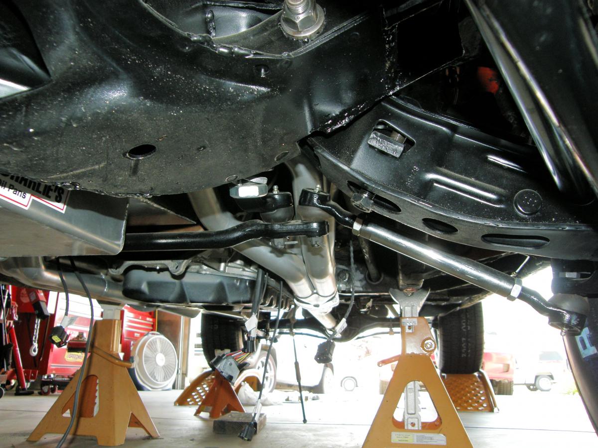

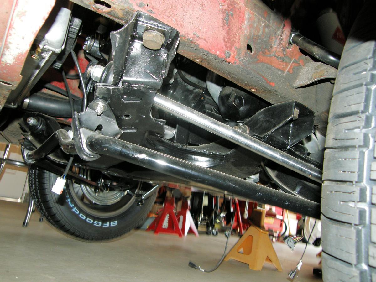

Here ya go. You can buy the plate from Mancini, or make you own out of some sheet metal. Also an up close view of the strut rods I made at work, then had hard chromed at our chrome shop. This should give you an idea of what I was talking about in regards to a more modern feel when I get to drive it.
Looks nice. For the LCA's, I can see the K-frame, but I don't see anything different about the LCA's than my stock ones. Is there a metal gusset or box you welded in that's not showing up in the photos? I'm probably just not seeing it.
I just ordered the LCA plates from Mancini. Hopefully there will be instruction included so I know how they're supposed to weld on. I learned that since I just installed a front sway bar these LCA plates are even more critical to prevent flex and optimize things.
The plate that is welded to the lower control arm "boxes" them. I take it by your most recent post, you see how they will look once the plate is welded on.
The plates from Mancini came in the other day and I had them welded on by my mechanic. They came out nice. I'll post pics in a few days when the rain quits.
