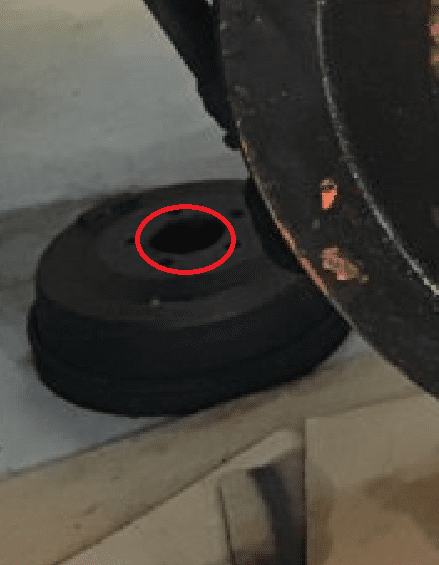

I'm still amazed he separated the other side, must have been restudded over time as the OE is swagged in place.
Hub does not need to be separated. It can be put on the drum cutting lathe with the bearings in.
I’m gunna leave it alone. I’m going to clean everything up and replace the shoes, springs and such. Thanks for your help.
No. That was off the driver side front@HD539, is the drum on the floor in your pic a rear one?
Wait, am I understanding correctly? You didnt have to take the cotter pin and nut off of the other side front? And the studs were knocked out already?No. That was off the driver side front
I’ll send pic. The hub pulled off without removing the cotter pin and nut.Wait, am I understanding correctly? You didnt have to take the cotter pin and nut off of the other side front? And the studs were knocked out already?
Im cornfused. lol
He didn’t do the separating. When an aftermarket drum goes on the shop cuts the swedged studs and now the drum and hub slide apart like the rear does.
Thanks for the red X Marpar.... Do you think everytime an old dodge came in for service they hammered the lug bolts out to separate the hub from the drum? Had both of mine, still factory OE, turned last year assembled.
Gave me a Red X and agreed with R413 and we both stated the same thing!! WTF
Sorry, but I took the cones out and the shop made me put them back in so the drum was perfectly centered as it rotates!I only disagreed cuz you said to leave the bearings in.
Oh and mine still has left hand threads in the drivers side hub.Lol. That’s why I posted the pics of mine.![]()
