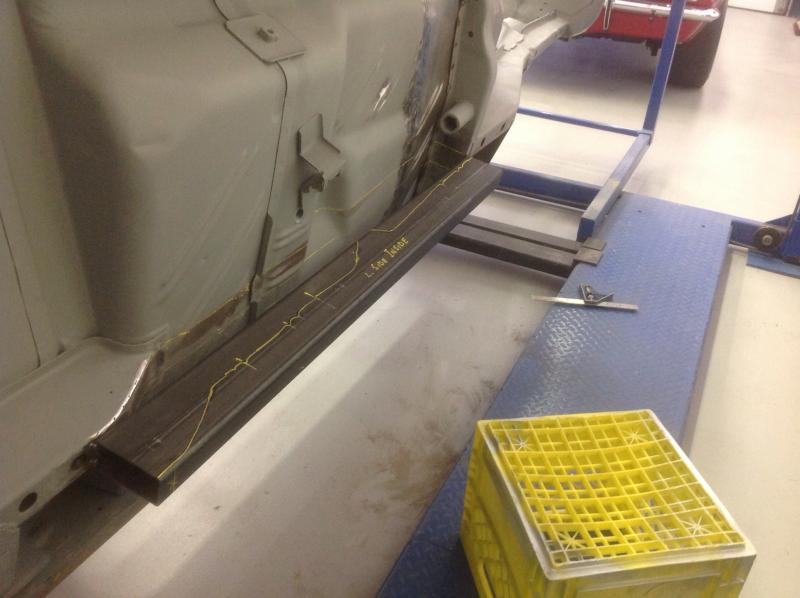

I made these frame connectors. I made a template of the floor and used 2 X 4 and went from there. That was before hearing about the US tool ones that you can buy now. I also inserted an angled tube for the e-brake cable to run through on the one side I recall. Was about 5 years ago. image.jpg
Looks great! Looks like US tool will save me from having to make them myself! Contacted them yesterday.

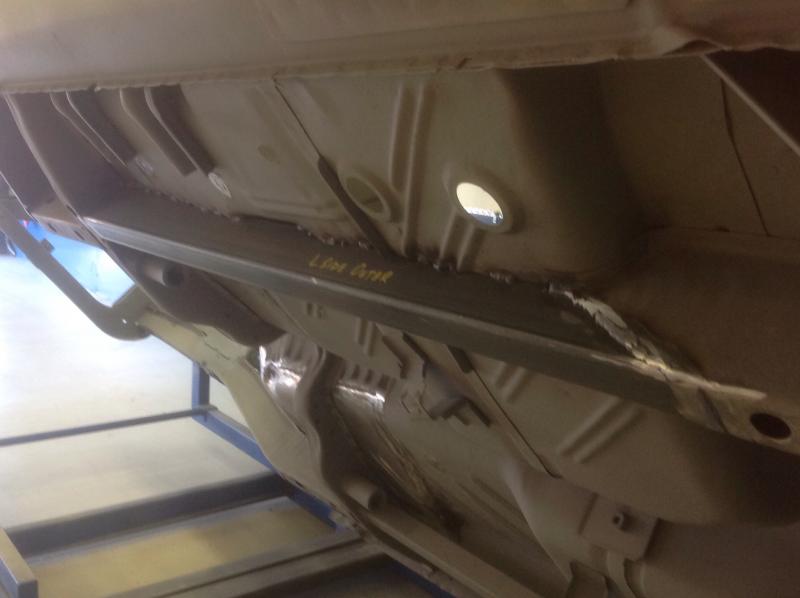

I made these frame connectors. I made a template of the floor and used 2 X 4 and went from there. That was before hearing about the US tool ones that you can buy now. I also inserted an angled tube for the e-brake cable to run through on the one side I recall. Was about 5 years ago. View attachment 214401

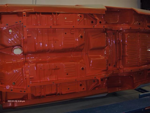

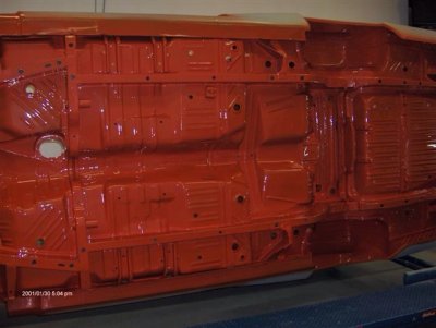

I have fab'd these connectors before on the rotisserie with no problems in any way. I'll attach a pic or two to endorse.

When adjusting fender gaps on an assembled car a fellow can increase / decrease gap by jacking so there certainly is some amount of flex.image.jpg
nice DIY Malex....
